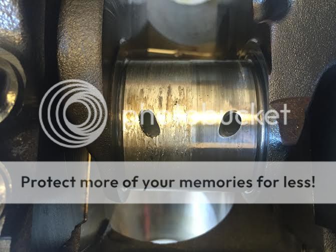

I agree, i have no idea what my oil temps are, i just had this convo with a friend last night about how we are clueless to what temps the oil is seeing. We use our oil pressure gauge as a reference.
To ram it home this is what happened to me, I only have dummy stock gauges and this is the result. For any type of spirited driving it's a must.
mrkaocf22 is offline
