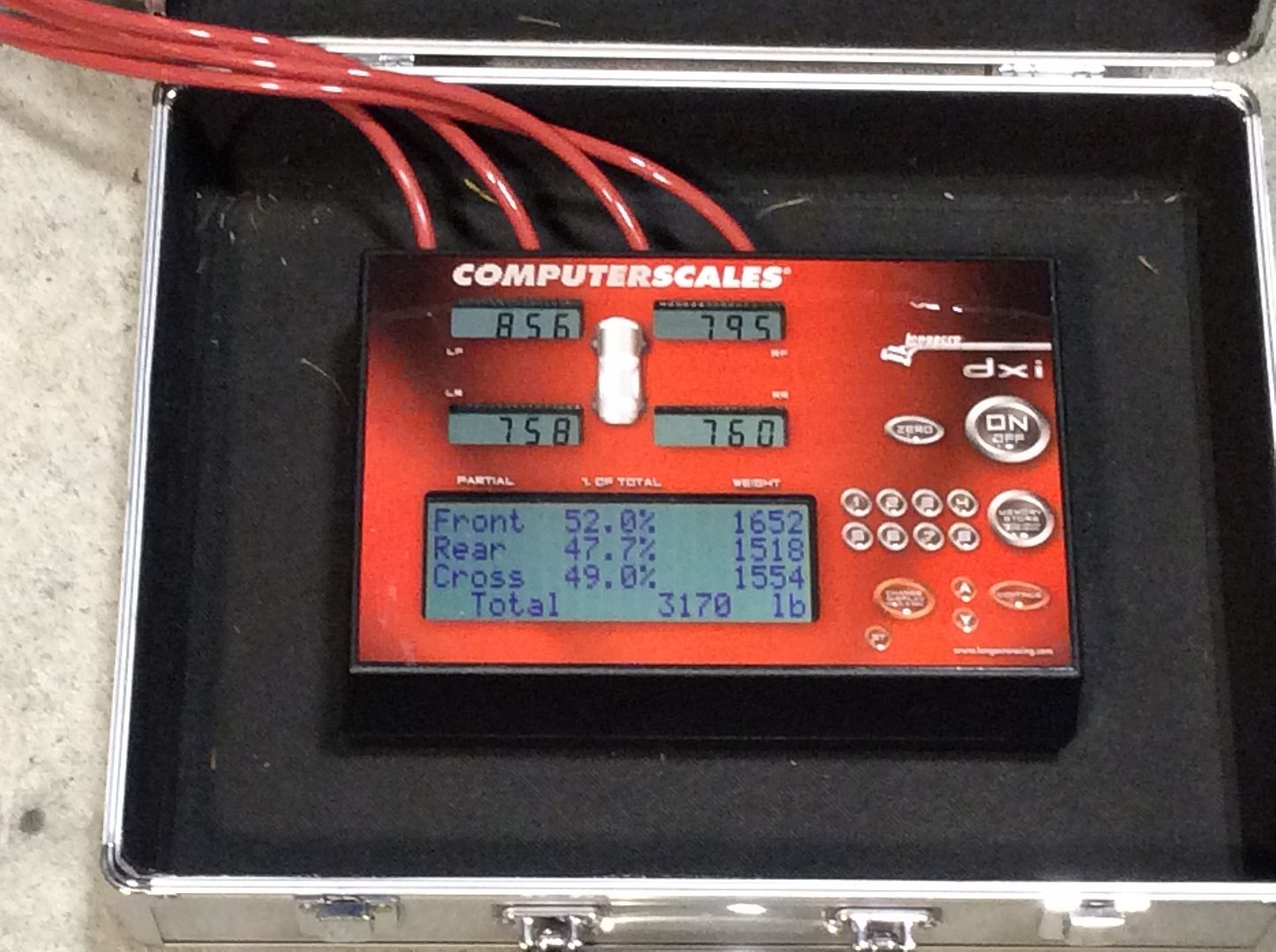

To be fair, when a car is at 50/50 or close to it, a little bit of weight makes the number jump a lot. Here is a picture of the scale with just 5 gallons of fuel taken out of the tank.
Curious...how come the total weight went up by 1 pound?

Posts: 766
5 gallons is 40 pounds give or take and about 1.25% of your total weight. Perhaps that is the wrong pic? Corner weighting changes can affect the cross weight but I don't think it will change the front to rear percentage.

Join Date: Feb 2012
Location: Levant, Maine
Posts: 2,264
I will have to check my notes. Maybe I ate a big lunch...lol
1.25% of total weight that is located about as far rearward as you can get. It does effect the front/rear more than you think. It is the leverage that makes the change more than 1.25% of the front/rear bias. If it was dead center of the rear wheels, you would have a point, but it is a good 12+ inches or more behind the rear wheels.

Posts: 766
You did not take out 8 gallons and only change the static weight by 1 pound. No amount of corner weighting changes will change the static weight although that would be nice. That was the main point I was trying to make. I will go look for corner weighting effects on front to back. I am fairly certain I have read that corner weighting will not materially change that relationship either.
Edit: I found an article by GRM on the subject. See second sentence under Setting Cross Weights.
http://grassrootsmotorsports.com/art...orner-weights/
But to your point. Yes a change like we are discussing can have a fairly profound impact.
