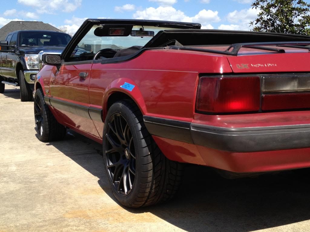

i got my vert when I was 17. Ive got a maximum motorsports 6 point roll bar and kirkey drivers seat with some knock off passenger seat. fits well, can still use the top. can kind of see it in this pic. best one I have.

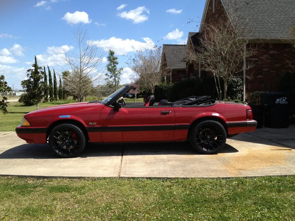

As far as tires and wheels. I currently have 18x9 and 18x10 SVE Drifts on my car with Nitto NT555 265/35/18 and 285/35/18. They have zero miles on them, but do not look like they will rub based on my past cars. The car is still mid, but this gives you an idea. Those pics are with stock suspension and I think no motor if I recall correctly.

Posts: 1,922
dat trackwidth and camber
