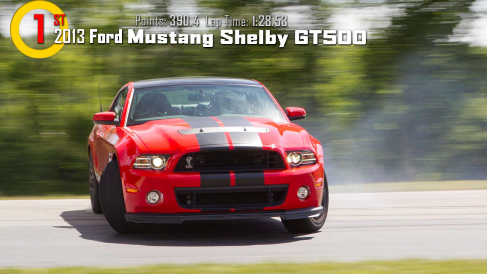

I almost forgot about the high powered mustangs that you drive right off the used car lot or show room floor such as the 660hp GT500
The 2013 GT500 has it all: tons of power, huge brakes, great handling and plenty of oversized fluid coolers to keep temps under control.
Then there is the GT350 with over 526HP right off the showroom floor.
