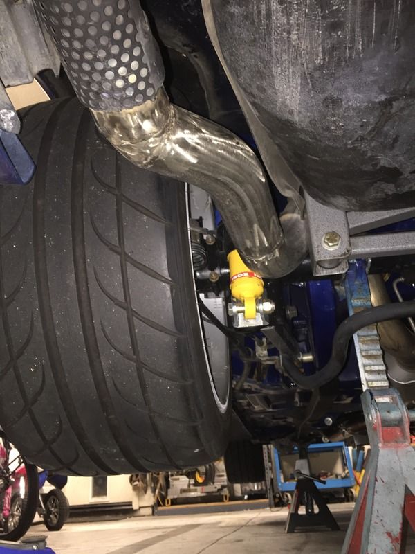

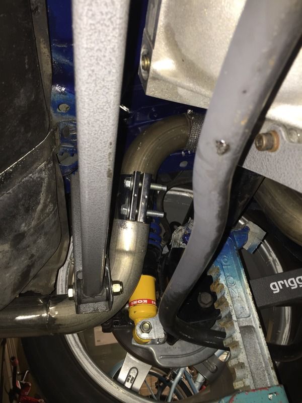

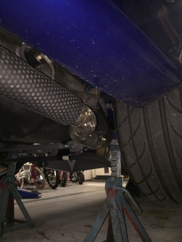

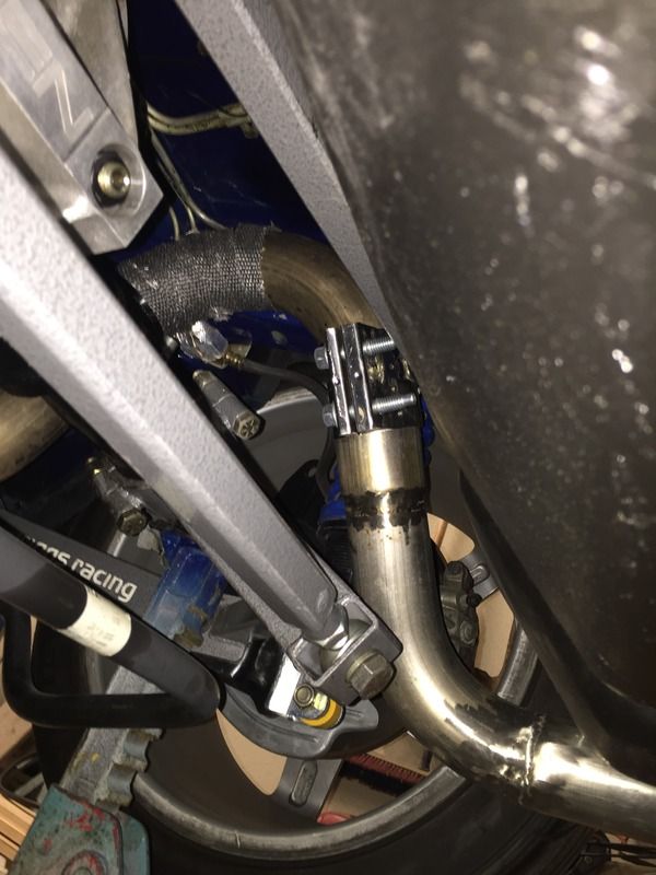

I started with a Borla and purchased two stainless 180* bends and modified it to fit. I cut the tube at the top of the hump over the axle and rotated it to the angle I needed to squeeze between the shock and panhard mounts. Then had to use pieces from the 180* section to snake around the tire and tank. It may not be the best flowing design, but it's not a race car. It's a toy and I wanted the exhaust out the back.

Justfloatn, that's pretty much my suspension setup, just need to figure out the tailpipes...your exhaust setup gave me a few ideas...the bassani setup I have has really nice tailpipes and I'd like to use them but the 180 over the axle is giving me problems hitting the phb mount....
