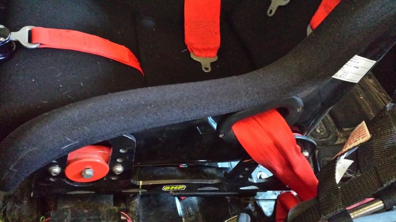

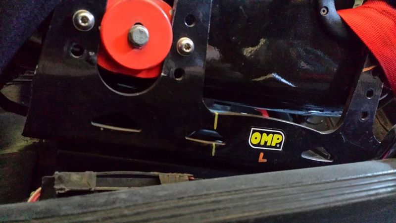

Here's how I have my semi-custom (narrowed) Profi SPG installed in my CMC, using an OMP mount/slider into what I believe were the existing holes. If I were to set it up myself from the start, I would have tied the seat mount into the cage -
Those brackets look to be about .25" material, steel? aluminium?
