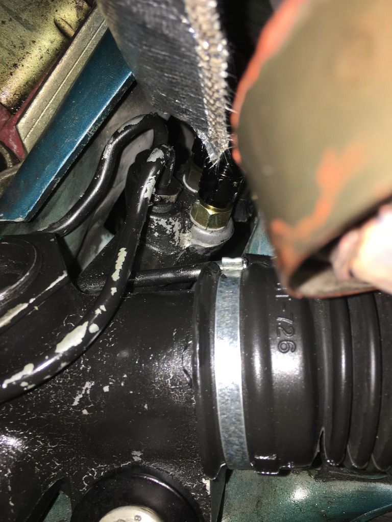

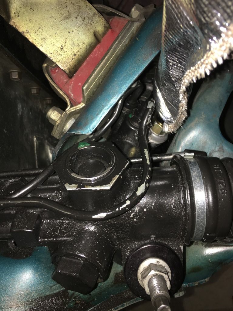

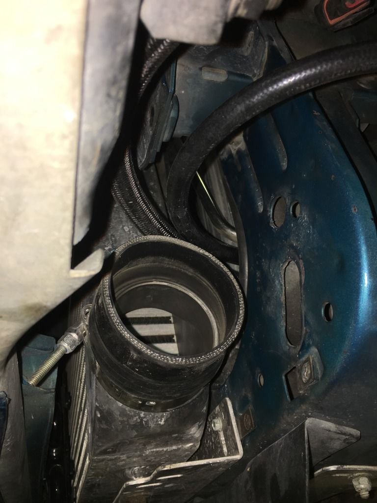

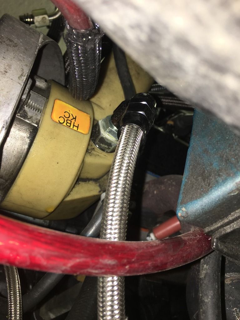

Well, luck has it I actually have parts of the turbo system out right now for upgrades and ceramic coating. So yes, I can get a few pictures that are not so cluttered.
Not much going on. Just a couple short runs of left over PTFE line. Hence the Silver & Black line. Top side of the engine I ripped out the Silver stainless line and put in all black plastic coated line.
I just used a AN fitting for the PS pump, and wished I could remember the part number. It just a simple fitting and washer if you Google it.
On the rack I just used the MM conversion.
I also used some heat shield sleeves as my exhaust manifold is flipped.
My car had the bare aluminum tube that is supposed to be the cooler. Not sure if it works, but figured can't hurt so I left it. Also wanted to run a cooler, so I picked the absolute worst place to install it and made sure it had near zero air flow. God bless turbo cars and stuffing 20# of you know what in a 5# sack. I was out of real estate so it is what it is.
Picked up a cooler off Summit or Jegs with -6 AN fittings pre brazed on.
Cut some old rubber line as protection for the lines.
As far as plumbing & line work. It didn't take much longer than a 1/2 hour. Obviously you can get more creative than I did, but you get the picture.
