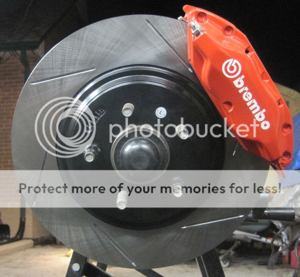

I don't recall, one of the boards or maybe on CC for the AI discussions. My calipers are a little different than the Cobra R's in that they don't have the curved lower clearance but are flat. I recall Darius Rudis put together some 2 pc rotors from a circle track supplier and built them for about half the cost of the standard $600/pr

Interesting. That difference in the shape could take away just enough clearance where the center hat fasteners would be that it would be a problem.

Yea, that's what I'm thinking. No idea -possibly an Alfa Romeo GTV or some other European (sports) car that used the integrated mounting ears. 38 and 42 mm pistons, so the same as the R's. Maybe the caliper shape is a money brake....and will prevent me from dropping more needless dough, lol
