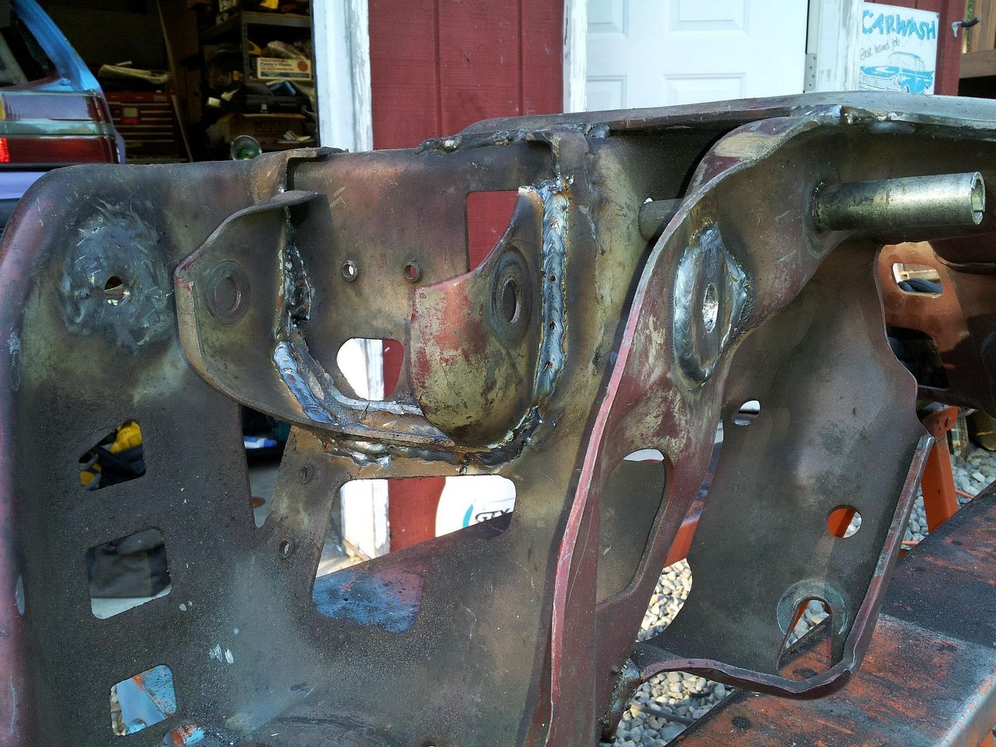

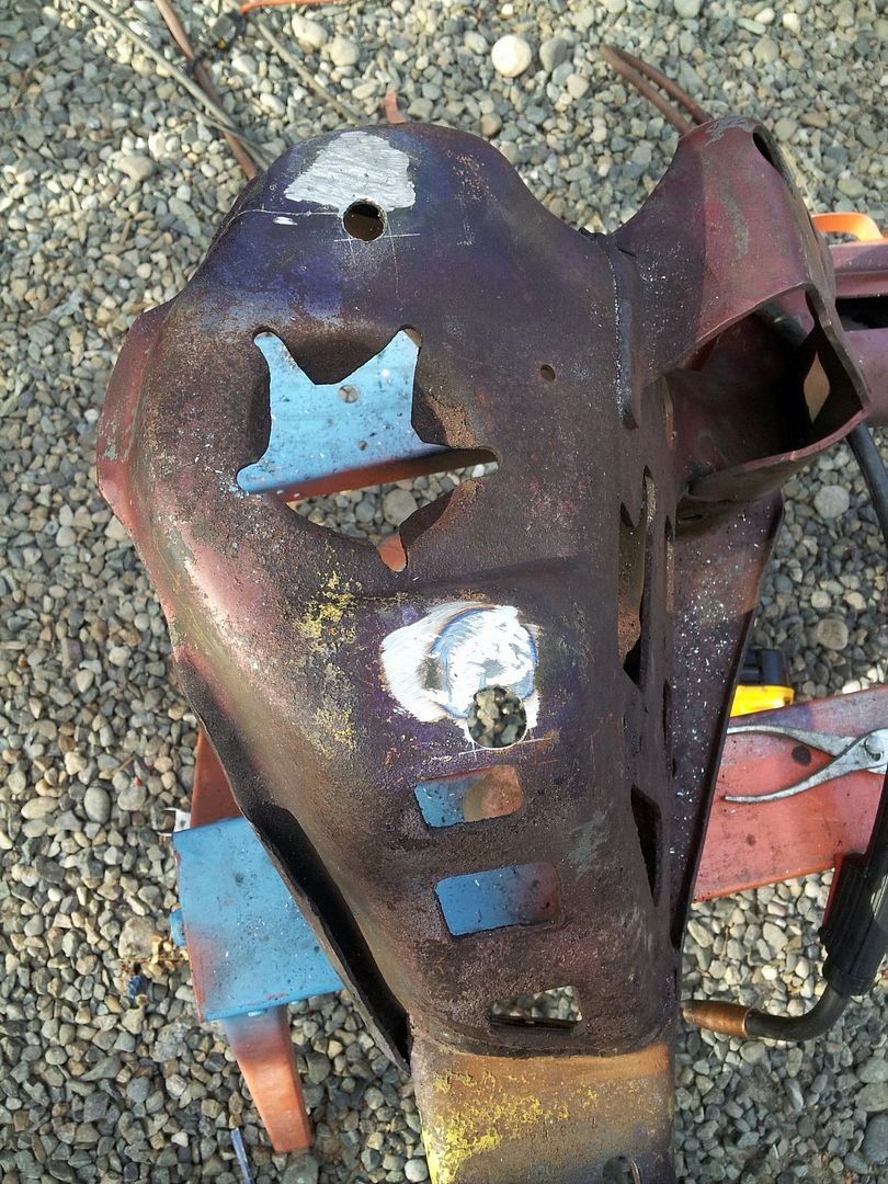

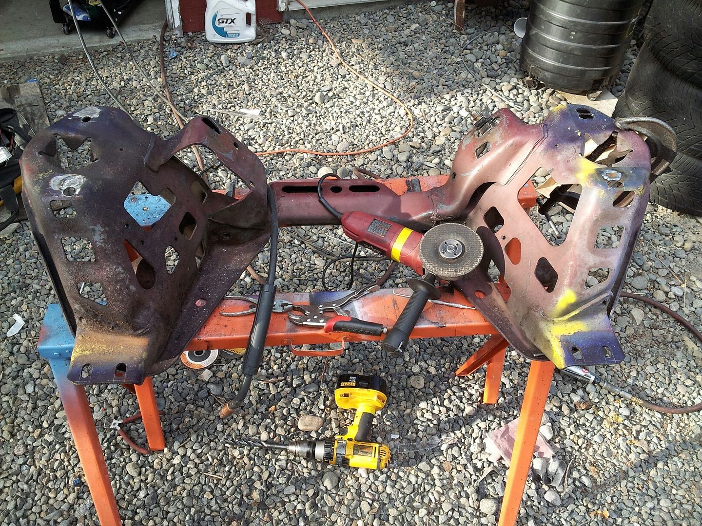

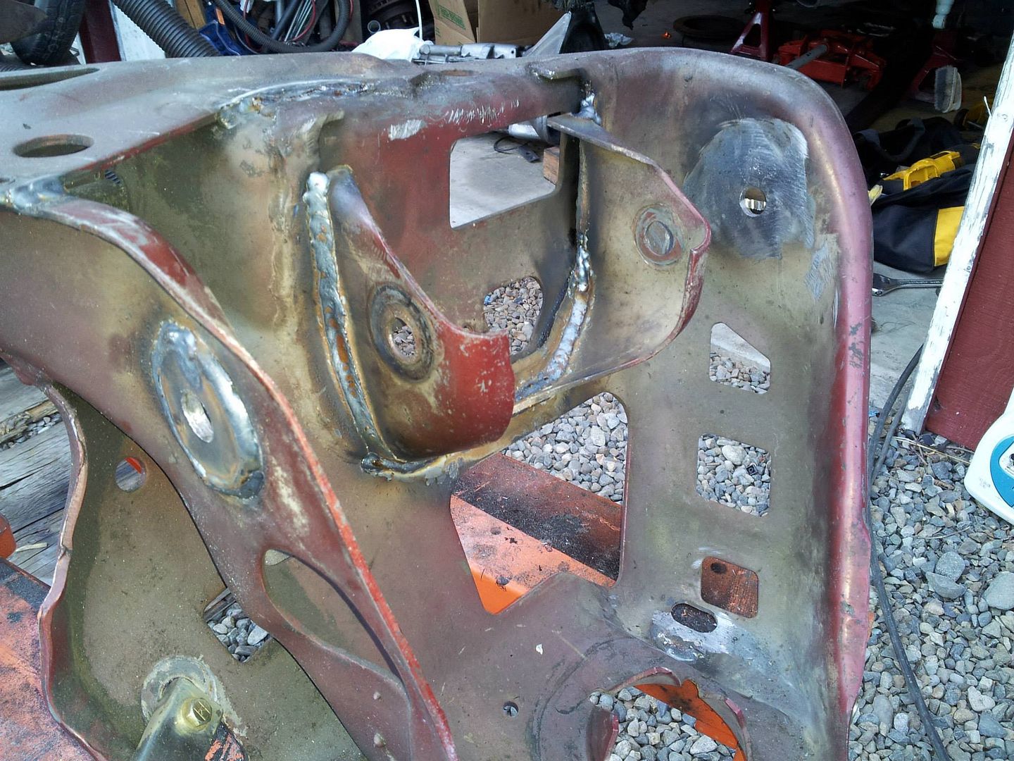

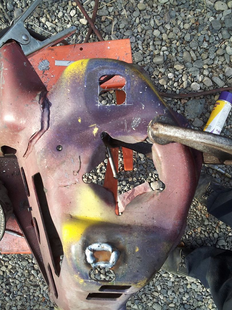

Like this? It's moved 5/8" forward per Mathis' recommendation. I think you run into interference if it's moved further. You relocate the motor mount holes, too, to keep the motor in the same place, but you can move it back 1", which is also recommended. I also moved the lower control arm mounting points up 3/4". I've seen people go up 1-1/2", too.
