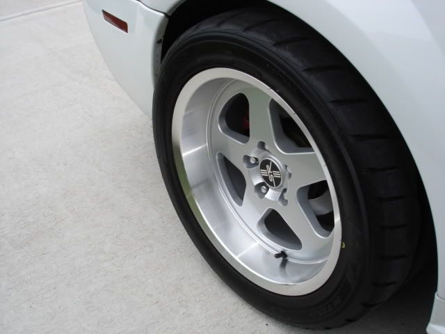

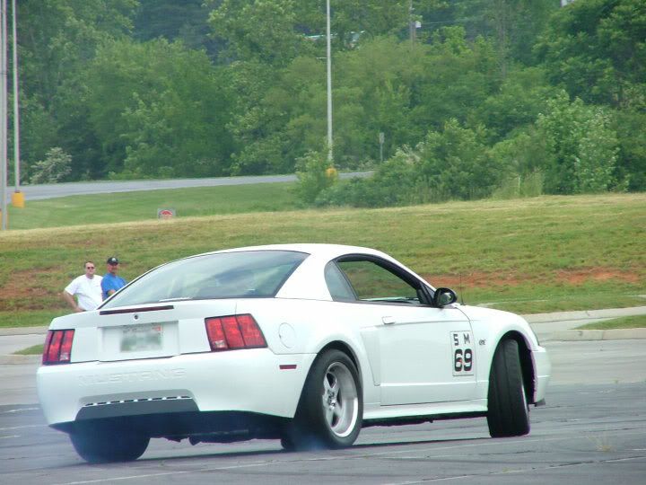

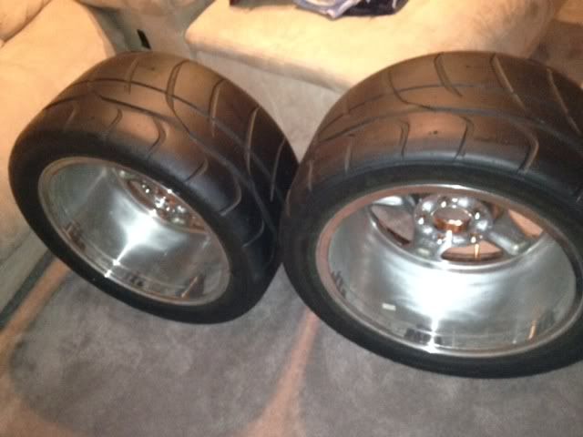

Don't know if this helps but here are mine on 17x10-1/2".
Do Nittos run smaller?

I think the Nittos do run about 0.4" smaller, so that should help my situation. Thanks for the pics!

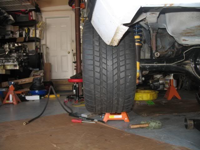

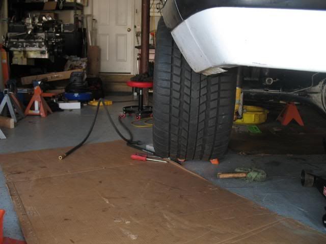

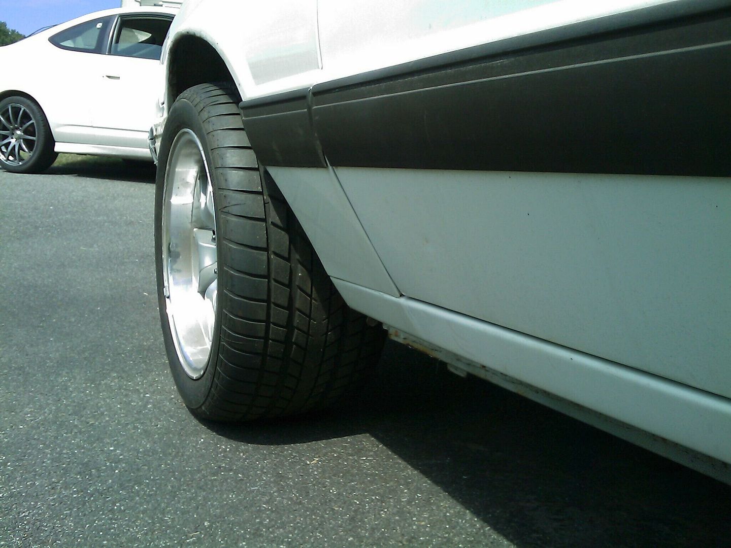

This is a few years ago when I ran 17x10 w/ A6 Hoosier 315's in rear, 295's in front.

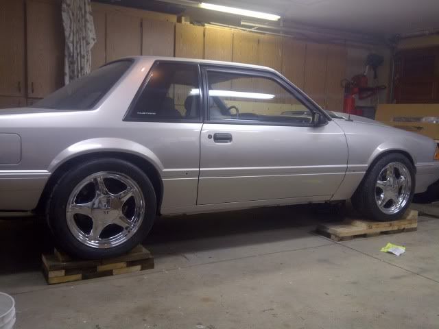

17x10 SC Replica's with 315/35 Nitto NT01's

The 315 Nittos look like they fit quite nicely on the 10" wheels. I may end up running that sort of combo on my widened Fox.

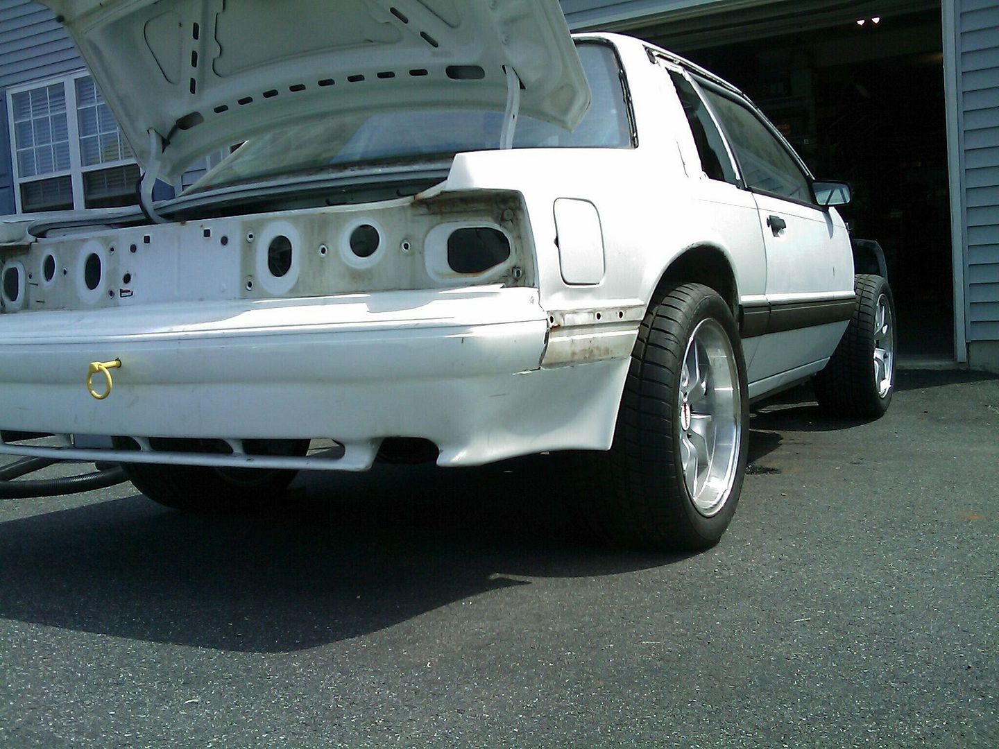

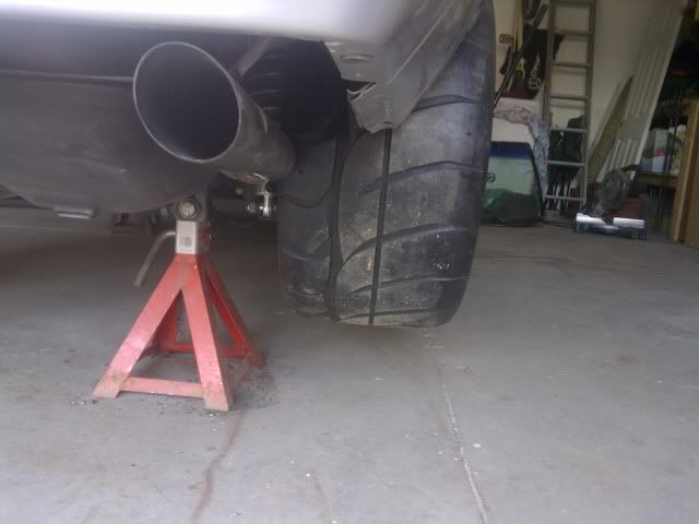

Here are a couple pics of mine 17x10, 315/35/17 Nitto NT01

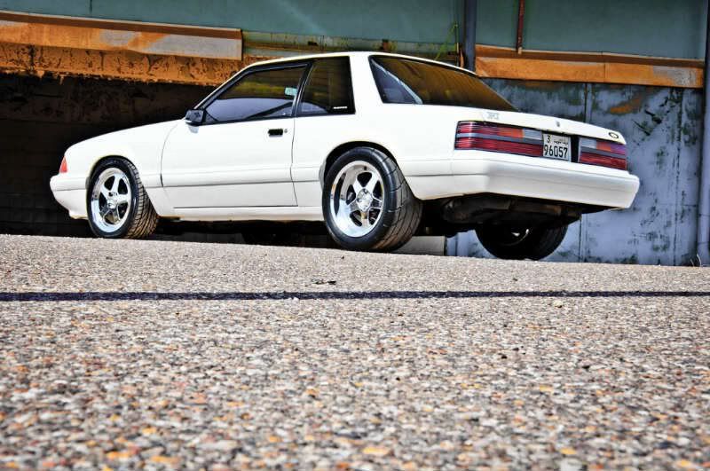

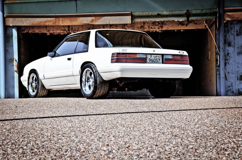

1993 fox on 17x8 front 17x10 rear SC Style Wheels with 315-35-17 Mickey Thomsons out back ..
That's just sick looking. I could stare at that all day.
