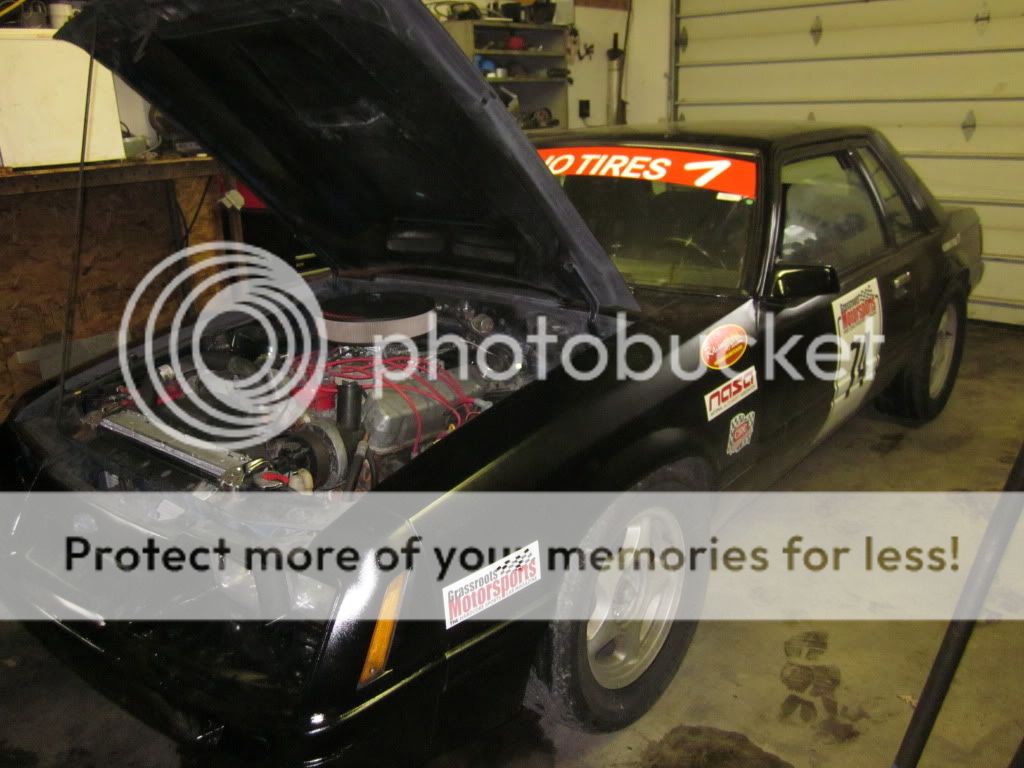

The following pic shows how badly she turns with really crappy drag set up

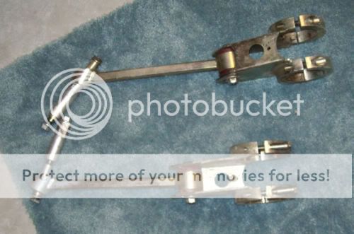

Steeda uppers
anybody who can seriously help me with set up, alignment, and any other serious help please feel free to jump in

Originally Posted by aussiesmg View Post
Steeda uppers
I think I saw those Steeda pieces on e-bay - almost picked them up myself. Since you are building a PHB, wait until that is done and installed, remove both stock uppers and replace the P/S with one of the Steeda pieces, thus creating a PM3L. This will pretty much eliminate the upper link bind common to the stock 4-link. The only concern I'd have is the strength of the one Steeda arm. That is why I didn't buy them - that and what I considered a high buy it now price. I'm running my own PM3L using a one-off rod-ended upper. Car was transformed.

Those are the ones, and it was the easy way to build a decent 4 link so i jumped in, before I found that auction I was going to build my own upper links. Both units are in excellent condition.
