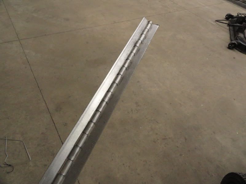

What hinges did you use and where can they be purchased?

The hinges I cut to size off a strip of aluminum hinge we use at work for meter boxes on propane delivery trucks. Its about 2" across with about a 1/4" rod through it.

I cut it to shape with a jigsaw with a really course toothed blade so it wouldn't heat up and melt. Cuts really easy that way. The top edge was the sawed edge from being cut at the place I got it, looked like a circular saw of some kind possibly.

The Tbird spoiler looks GREAT!
Originally Posted by sydewaysix View Post
Han Solo...how would you make one of these "slip over?" I'm curious because I have a s281 spoiler on my 98 cobra and if I can keep it intact and just "slip" added aero onto it that'd be awesome! Do you have any pictures of how that would look/work?
Nah, I was just thinking out loud. If I get around to trying it and get something to work I'll dig this thread back up and add it.
