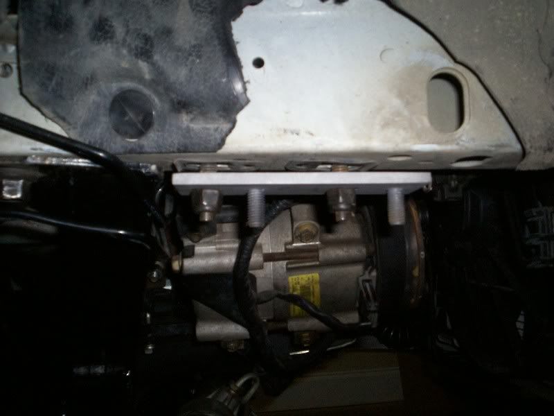

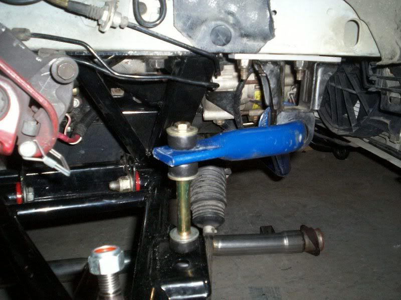

Just use some plates/flat stock and space the swaybar down at the frame rail D-brackets.
Something like the below, but without the horizontal relocation:
2k2GT is offline

Hmm...not a bad idea. Why did you relocate yours? When my LCA are in full droop, it really lifts off the end link bushing underneath.

Just wanted to add a "me too" on spacer plates...

The relocation bracket is typically used if you have forward offset control arms.
