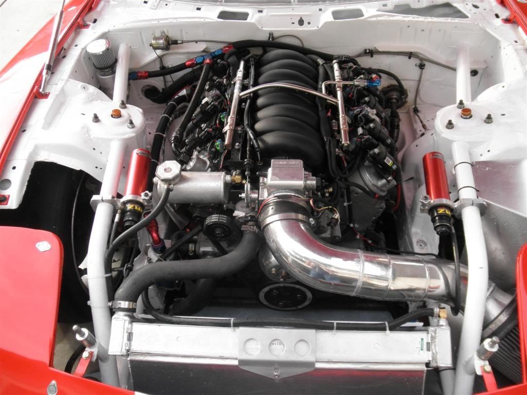

Car is a '93 Mazda RX-7 with a 438ci resleeved LS7, Aviad dry sump, GForce dog box, Cobra 3.27/T2-R rear, and 18x12's with 315's front/335's out back. 2400lbs dry with a little over 600hp. Entire chassis was sandblasted and then powdercoated. Won SCCA ITE West Coast last year with a 383 LS1 making 100rwhp/100rwtq less.
Thx
Some pictures! I'm pretty damn happy with the purchase thus far. Plan is to learn to drive it better, then potentially race in the future.
