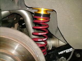

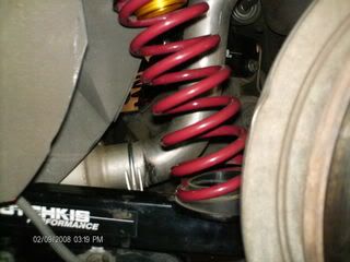

Sorry to bump this thread, but I have a spring rate question for my setup.
Coilovers up front with 200 lb spring
Eibach sway bars
Griggs Torque Arm and Fays2 Watts link (not installed yet, spring 2012 upgrade).
I have this rear spring setup on my car, with a 250 lb spring currently. What spring rate will I need with the Torque Arm?
Pictures used as reference, as my setup is the same.
Trying to get my ducks in order for next spring/summer.
Appreciate the help!

Originally Posted by 2dxtrm View Post
Where'd you get the upper seats for those coil springs? Those are too cool!
'87 Fox C-Prepared Mustang
Zero scrub SLA front end
87Fox5.0 is offline
post #35 of 50 Old 11-24-2011, 11:02 PM
Location: Ontario
Posts: 1,712
They are part of the Eibach Pro Street Coil-over kit. Got the complete kit gently used from a friend who was turning his car into a drag car at well below bargain basement pricing.
