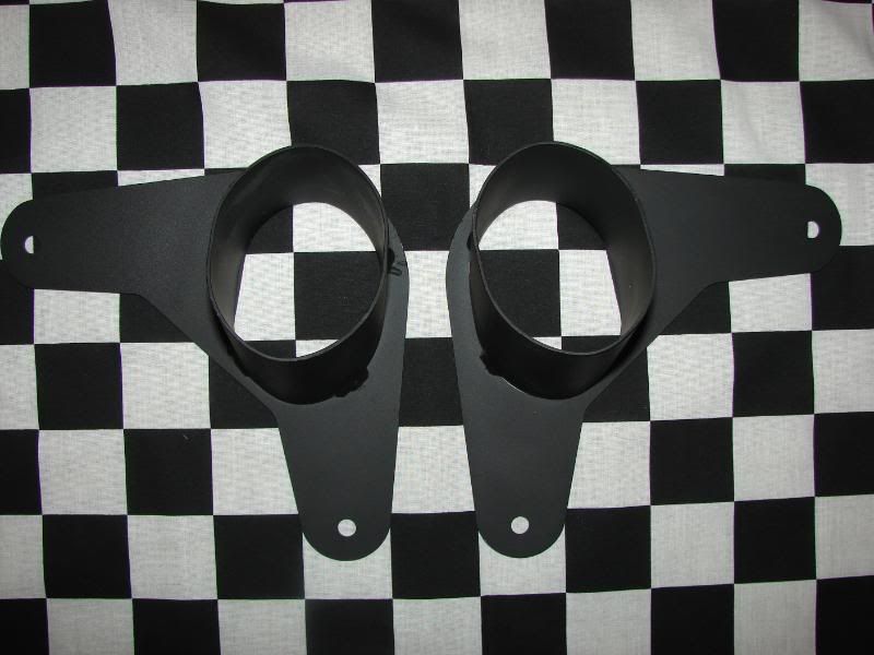

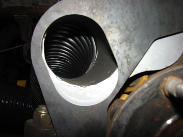

Here are the pics. The duct placement is a compromise, but its packaged well inside the space given. Delivery of the air to just the center of the rotor would require either a different backing plate design or use of composite material. I can do either but then my goal of providing an affordable backing plate setup goes out the window.
Is cooling to the center of the rotor preferred over cooling of the disc?
Maybe for keeping the bearings/hub cool over keeping the disc cool?
What diameter sizing is that hose?
Does this completely replace the factory dustcover, or do you cut a hole in it and mount this as well?
What kind of hose is that, and will that stand up to racing and DD usage?
Sorry for the all the questions, just excited about finally being able to do this!

I don't supply the hoses any more but I will give you a link to where I bought them from. Theyre great quality high temp hoses and the price is the best Ive found anywhere online. Everything else is still included in the kit.
The stock dust shield is completely removed then the backing plate is bolted on in its place.
Sorry for the confusion the top pic is comparing my old backing plate design to the new oval design.
My setup is designed for 3" diameter hoses.
If youre interested in a set of backing plates, email me at
[email protected]
