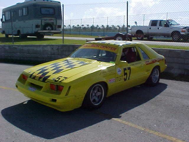

In reference to your brakes. Pre track day preparation is very important. You don't want to go out there on old brake fluid and poor quality pads/shoes. I raced an SCCA Mustang GT on stock 1985 Disc/Drums and, granted they weren't the quality of todays systems. They were fine, but......It we used good quality, track rated fluid, high performance pads and shoes and had cooling ducts also. Your brakes are going to take a beating as your skills improve so be prudent and prepare your car before you go out there. There is a wealth of information on this sport so continue to ask questions.
Here is my old racer with the disc / drum combo.
