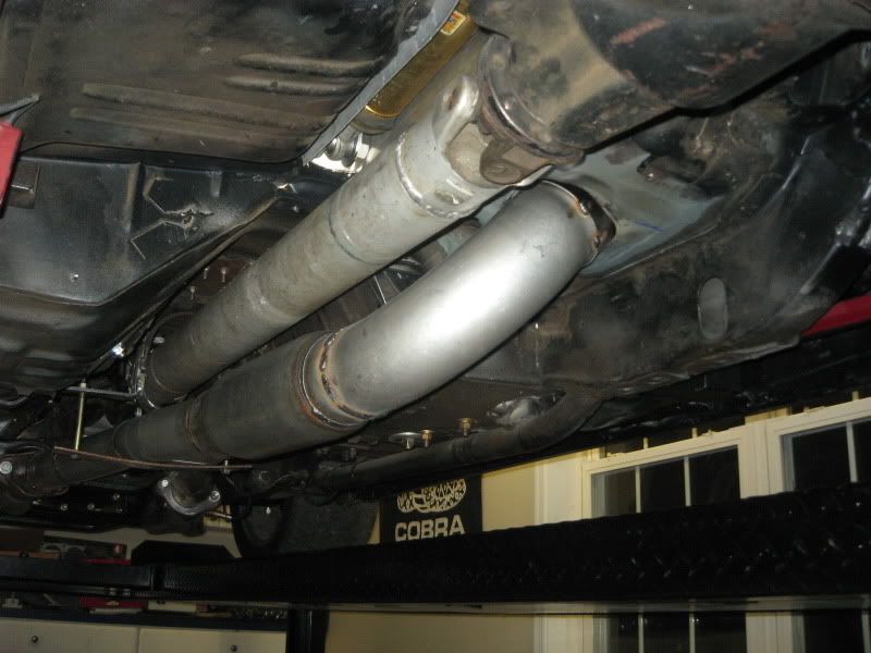

I sortof copied Darius' car, but I wanted the exhaust to only exit on the passenger side. 3" pipe off the headers into a "Y" pipe w/ 4" pipe out of the "Y". Small race bullet muffler, then up and out the passenger side quarter.
