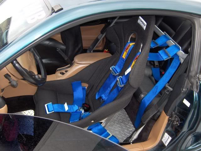

100% correct. Here's my old setup and how you should mount your straps.

Oops, I got thrown off too. Nothing wrong with mounting them to the rear two seat bolts. Or another idea you can see in my pic is mount them to your existing seat belt points. Mine are done this way and the stock belts are still there. Plenty of room if you decide to leave the stock stuff and mount the new ones.
Yeah I wanted to mount outboard lap belt the way yours looks to be but OEM bolt is not long enough to go thru OEM belt and new lap belt. If I got a longer bolt I don't think that the OEM belt would be able to pivot the way it does on the factory bolt. Also how is your inboard belt mounted?
