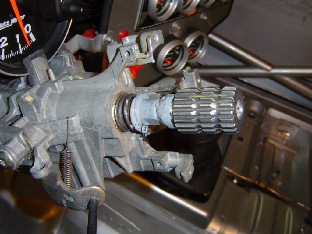

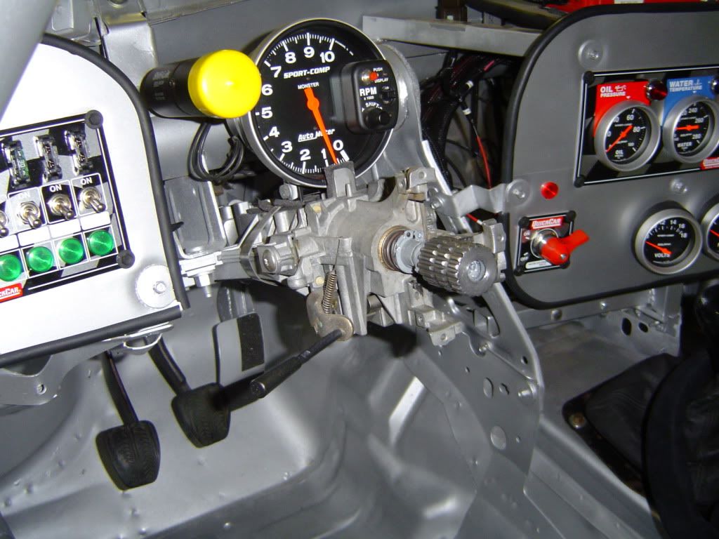

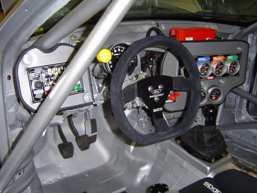

Sweet Mfg. is now offering a splined 6 bolt quick release hub. Welding required.
I have it on my SCCA race car. I welded a 5" extension onto the stock steering shaft then welded the splined hub to it. This moved the steering wheel back closer to me and with my remote shifter, the setup works very well. I'm 6'3" and I sit very far back and low in the mustang. I'll try to get some pics up soon.
Pics are up!!!

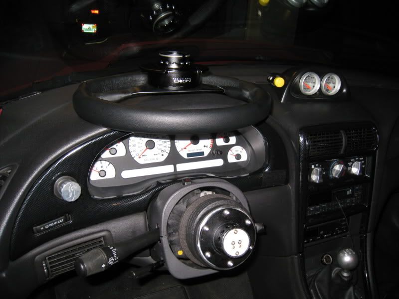

I'm using an OMP Targa wheel, Sparco quick release and a Momo hub.
96 GT / 4R70W to 3650 swap, some metal tubing, Recaro'd, and slightly Griggs'd.
Thanks to my sponsor Performance Autosport!
96sohc is offline
post #14 of 35 Old 02-09-2012, 09:22 PM
sirl's Avatar
Join Date: Oct 2007
Location: Ft. Lauderdale, FL
Posts: 437
soo, im now using, MOMO adapter hub, NRG QR thin, and Sparco 300 wheel, i like it alot!
good for anti theft,
a must for ppl who have cages,
Same setup.
The NRG THIN piece, keeps the steering wheel in the stock location.
The pic is when I had the thicker (regular) adapter. I later got the THIN adapter. Its the only pic I've got of it.

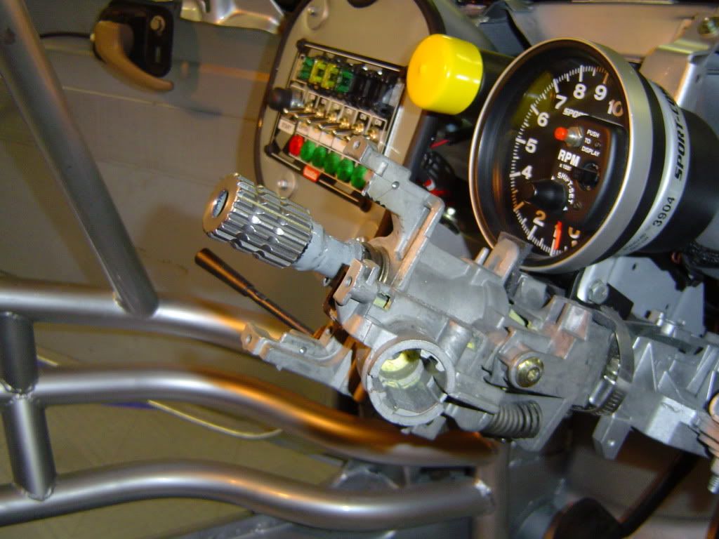

I welded mine on like this

Longacre Part # 56605 splined Q/R
Pressed over stock 2004 column then welded in place with Ford Racing Sparco wheel.

Originally Posted by CSG View Post
What is everyone using to mount a quick release to their mustangs? I would like to add a quick releases Momo suede wheel to my 98. If it spaces the wheel closer to the driver that would be a welcome bonus.
Momo Hub
NRG quick release
Sparco wheel (insert your momo wheel)
