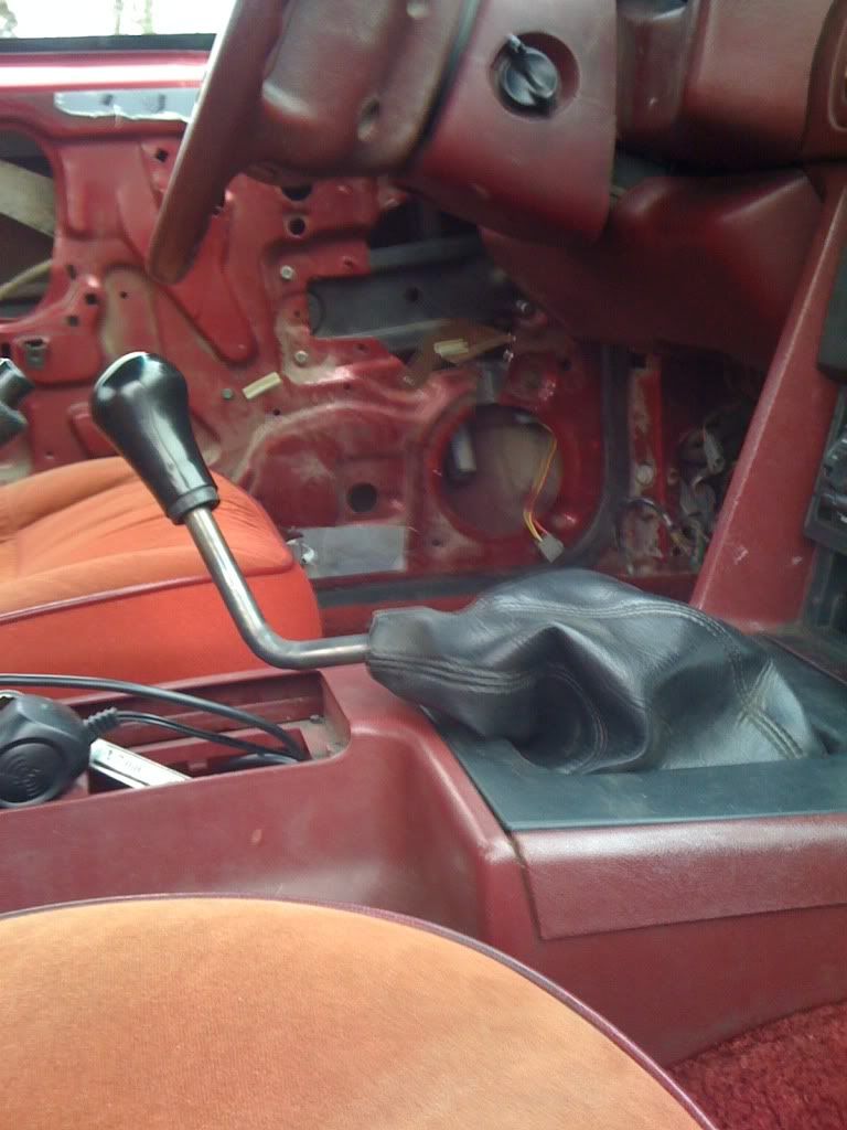

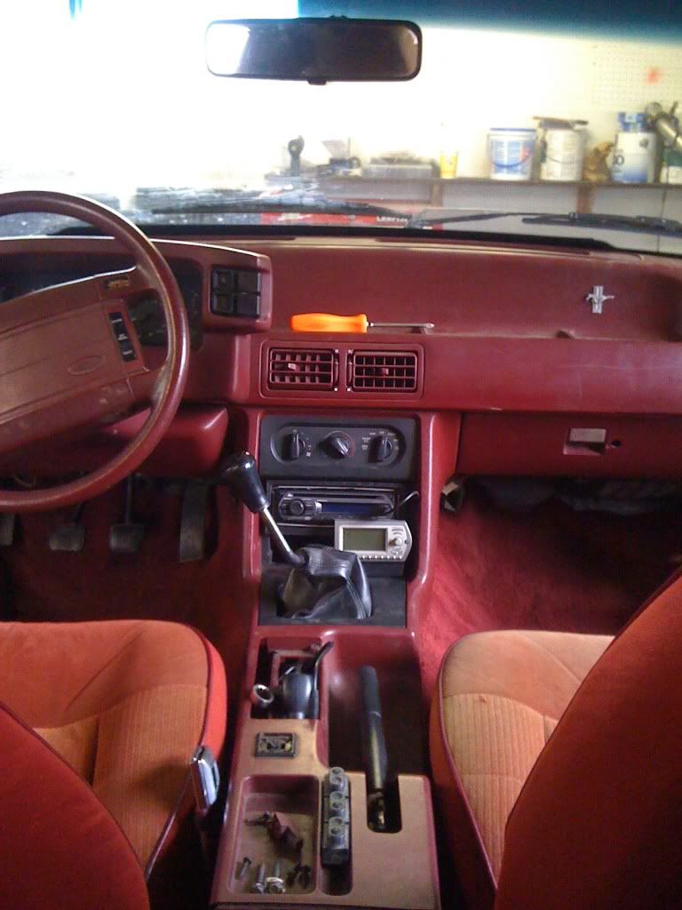

This is what I did I am tall and have to put the seat all the way back for leg room and couldnt reach the shifter like I wanted. So I got some round stock and plate steel and fabbed up my own. It will be topped with a hurst ball eventually. Its around 2'' more pull back then the stock handle, about 2'' more toward the driver, and about 2'' taller.
Here are some pics next to the stock handle
Some assembled pics
1-3-5 position
2-4-R position
Some shots from my POV
1st
2nd
3rd
4th
5th
large from back
1980c10 is offline
