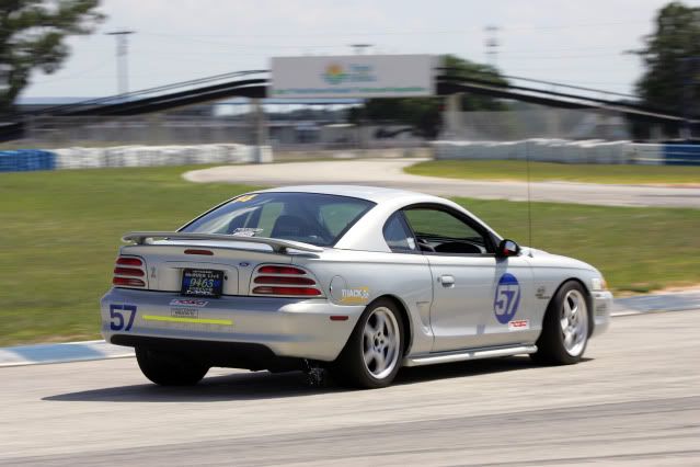

Happened to me again at Sebring over Memorial day Weekend with Track Guys, inc as you can see in the pic below. This only happens when my tank is at 1/4 or less....
