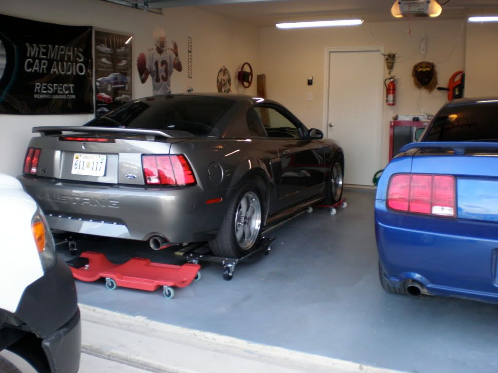

What is already on the car is more of a hodgepodge of parts. We will start with what is staying. First off I do have a K member on the car. It will garner some laughs I know, so let us get them all out of our systems.......................and we are done. It is the steeda I pay way too much for a k member............and we are done with laughing part 2. It is staying on the car because I like it and the wife bought it for me. Also have a set of MM C&C plates and sub frames that will be going on as well. Now for what is going. The car currently has OE dampeners on it, and sportline springs. It also has the tires that were on it the day I took it home from the dealer in 01. Here is a pic of how the car sits as of now.
