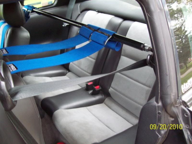

strength of the B pillar from the heat may be compromised... but if the op uses a loop around (wrap around) style harness belts and not the welded tabs if the bar moves the belts should stay with the driver, not the bar.
I have a bolt in style harness bar and one very distinct advantage to a bolt in is the ability to remove it if I ever decide to sell it (most every one will sell someday)...
I also figured out a way to remount my factory belts to the bolt in bar so I can run the stock belts on the street (street legal) as opposed to the harnesses (not street legal)
My bar is made by Stable Energies
Thanks for the info. I assume you have this bar: http://www.stableenergies.com/Guide-...oductinfo/GB3/ ?

^^^ Yep, that's the one!!!
