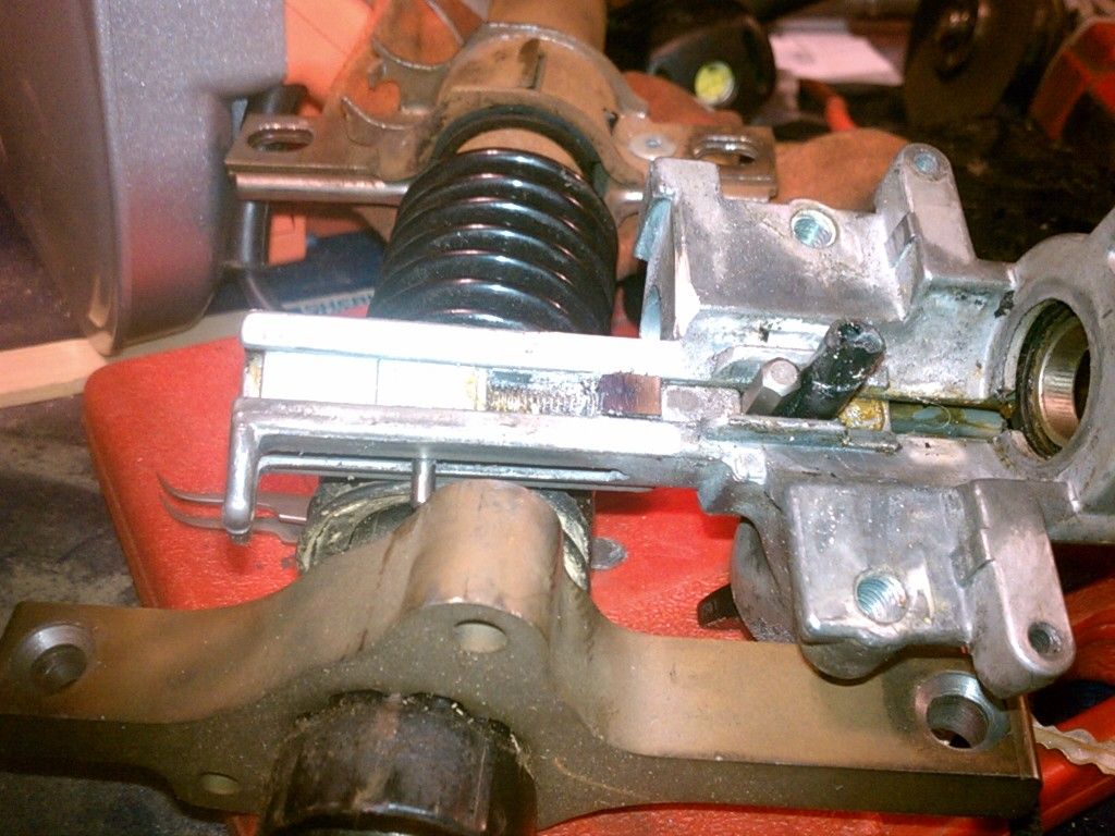

here is what I did for the newer columns.
There is a ring on the column shaft that has 2 detents cut into it. I tried to remove the ring but ruined a column trying to press (BFH) it off. The solution is to remove the lock assembly as previously described and grind down the sliding tab that mates with the detent in the ring if the key is not turned. I used my bench grinder to grind it down below the housing its in (grind housing too.) it now turns freely key in or key out.
Use the key to compress the spring then stuff something in to kepp it compressed so you can grind the tab down!

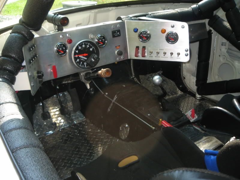

If you work hard enough at it, you can completely gut the entire steering column and remove just the 3/4" shaft. That's what I did, then used a circle track style steering column arm w/ 3/4" ID bearing to mount it. Welded a quick release all voila' - a clean simple collapsible steering column. You may not want to go that extreme though...
Had to put a 1" (??) bearing in the firewall too though as I removed the mount tube that bolted to the pedal box.
Stock steering shaft....
