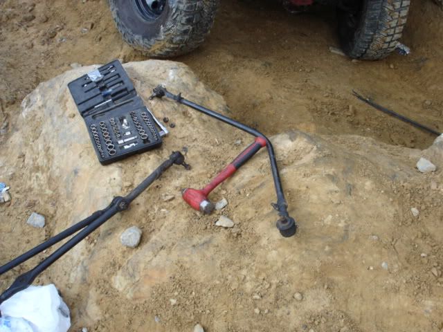

Looks like what I did to the tie rod on my Jeep. MFE, I found some super sticky sandpaper/non-slip stuff at Tractor Supply(I think....maybe Lowes/Home Depot). I stuck it on the bottom of my torque arm to help prevent accidents like this. While the stick on stuff isn't bullet proof(as it shows signs of being jacked up), I've been able to push and pull the jack and move the car around with the ass end jacked up now.
I carry the now un-bent tie rod with me as a spare. However, I did shove some round stock steel in the hollow tube to aid in reinforcement. I'm using a SOLID STEEL tie rod bar, so I don't see it bending any time soon, though.
Oh, and maybe fix that diff leak/seep. How in the world do you pass tech with that!!!!11 LOL!!
