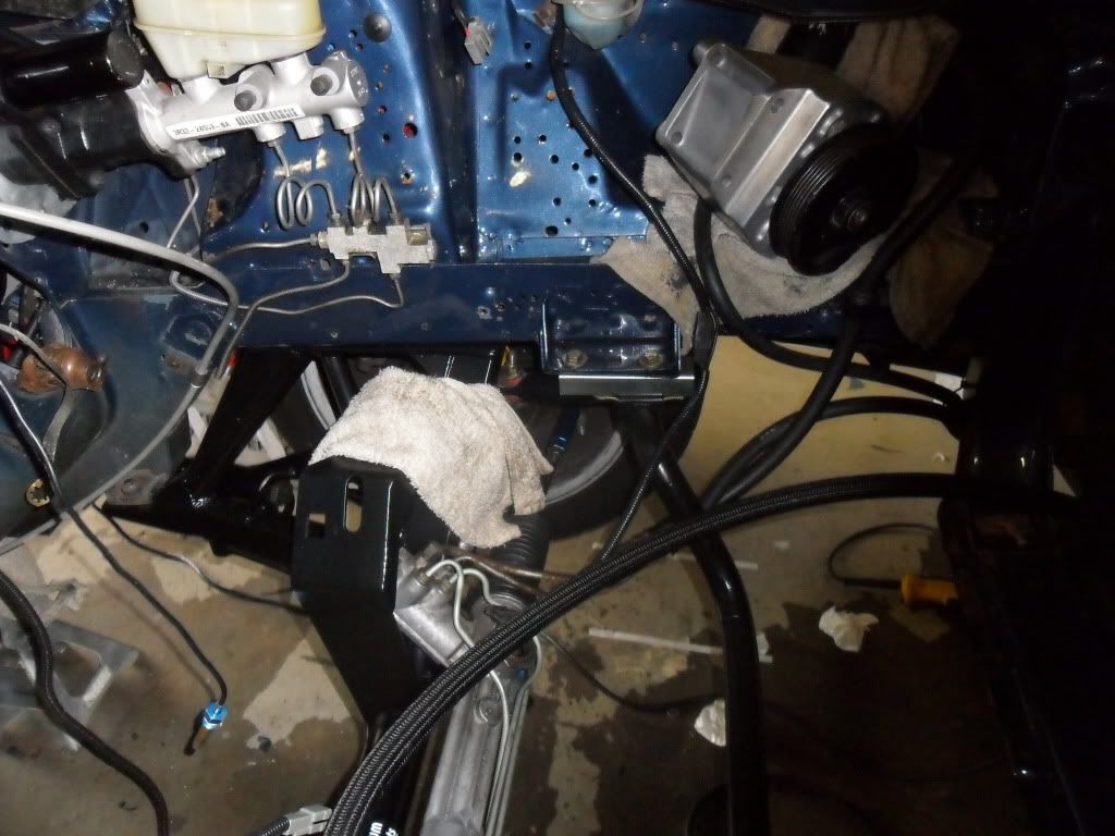

That is our 86 LX Coupe Shop car with the MM modular swap K member and sway bar all bolted up.

To my knowledge MM does not make a special sway bar for mod motor swaps. ON the fox 500 projects one of the magazines did they mounted the gt500 motor in and it does not look like they changed sway bar mounting points.
It might make a difference on ours that we are running forward offset A arms. Thats what the zinc coated blocks are where the sway bar mounts it pushes the sway bar forward.
That is a stock 5.0 sway bar.
