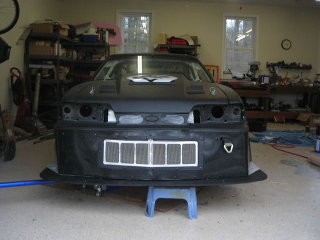

Toys: Heres a interior pic of my car... I welded a 1.75" square tube between the main hoop bars, bent to fit the shape of the floor. Its welded to the main hoop, the main hoop mounting plates, and the floor at the center hump. The vertical bar was added, at the bottom is a 4 hole bracket that my upper 3rd link attaches to. Per AI rules all linkages have to be covered, so I made the aluminum cover you see in the pic. Its easily removable so the 3rd link can be adjusted. If I had it to do over again I would just use a sliding type link attachment to the vertical bar to have a more adjustable link.
In this pic from under the car you can see how I changed my RLCA chassis and axle attachment points. I dropped the axle mounts 1", and cut out the torque boxes, moving my LCA attachment points forward. I started with a 3" (maybe 4"?) steel channel, cut out one side, then cut it to fit between my frame rails and the rocker panel. Its welded in place and through-bolted to my main hoop mounting plates. There are two holes in the channel that the LCA can be bolted to - one is 1" lateral to the hole occupied, if you wanted to change the convergent angle of the LCA's in plan view. The front mounts can be raised or lowered by changing the spacer stack - this will change your AS and roll steer a bit. Now all 3 of my rear links are adjustable... Also in the top L of the pic you can see my 3rd link attached to the roll cage...
Another pic of the LCA mods on the other side. The hoop is a tiedown point. The zip ties hold my flexible brake lines that run along the lca... You can see the hard lines in the first pic above...
Finally,two pics taken a couple of weeks ago... the car is getting very close to being completed, hope to run it Sunday at Summit Point for an easy break-in session!

Ed, nice work and thanks for taking the time to share. Did you do any anti-squat and roll steer calculations? Curious where you were able to get for both. I can't seem to get much above 51% AS attaching to the cage like you did. I'm also sitting at a 1/2 of a degree of roll oversteer. I'd like to be able to adjust AS from 50-90% and get to roll understeer or at least neutral. To be honest I'm not sure how much roll steer I need or how a 1/2 degree is out on the track. I'm also playing with moving the lower arms around like you did.

Thanks for the pics! Love the car.

Originally Posted by Toys View Post
Well, how was it?
Mike; didn't get enough track time to really tell.. Ran into two problems right off the bat. First my tires were crap - I had an old set of AVON Tech R's on it, I took the R6's off last fall after my last track event, put the Avons on for winter storage. Never got a chance to swap them before I went to the track. Nearly looped the car several times on the warm up lap....
More significantly I had a oil leak off the back of the boss block that I couldn't find/control, so I ended my track day after the first session. Its either the rear main, the cam plug, or one of the two oil galley plugs. Its not the pan, a valve cover, or the pressure sender port that's leaking. I loaded the car back into the trailer and came home.
But I think it's going to do great. The track we were on (Shenandoah at Summit Point) has 17 turns in 1.7 miles. Its not high speed at all, you're nearly always turning. The car turned in better than ever, but on the ball bearing tires it was very hard to tell anything at all. Still have some work to do before I'm done...
My next time on track will probably be at VIR in July with the NASA event there. Same weekend at the GRM ultimate track car challenge.
