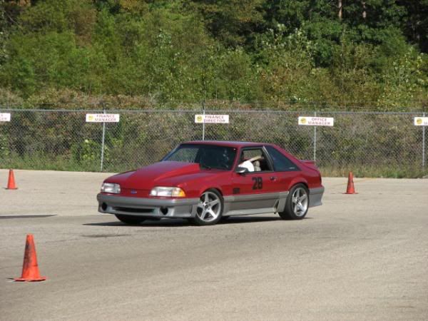

Posts: 5,911
Tim ||||||| ||||||| |||||||
07 Subie Impreza - DD
92 GT SSP
XBL: Zexterr
Sent from my Droid using Tapatalk

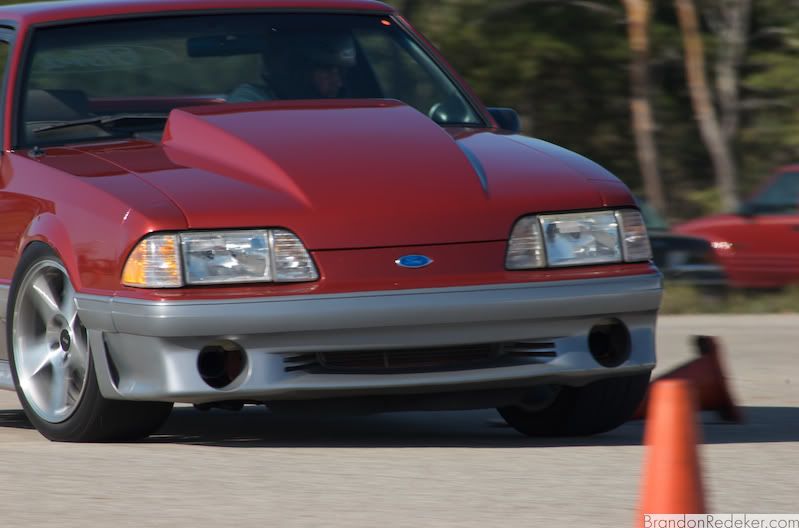

Originally Posted by greengt88 View Post
wow ur fox cars sit way lower than mine does, i see the general concensus is keep my 04's, roll the fenders a bit, it's more rubbing on the inside of the actual wheel itself, grinding is more like it. i think it's hitting the a-arm. how do i cure this, steeda told me rack limiters, my turning radius is already crappy as it is.
I use quite a few rack limiters. I just learned to plan my tight turns ahead of time. There is always steering with the throttle to take care of those pesky tight turns.
That pic of mine above is while the car is rolled over. While it isn't in 4x4 mode, it still has some fender gap.
