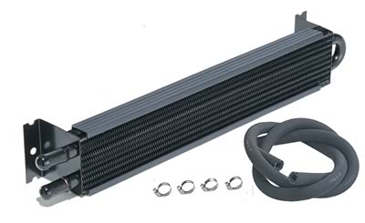

March pullies, a/c, p/s (with cooler in front of radiator) running non-synthetic Type F fluid and a 96 Cobra steering rack

On the topic of steering, I wanted to post a pic of my p/s cooler setup. Got this one from Summit as I was worried about overheating the power steering fluid, which many have said was a problem. In 100 degree heat, I had zero problems with the fluid. I am running Valvoline brand non-synthetic Type F and a newish Motorcraft replacement pump that I bought off eBay.
The cooler I am using is a Derale (# DER-13224) that I got off Summit for $29.95, which is perfect because the overall length is 23.5" which is the same as the distance between the a/c condenser brackets in front of the radiator. Two 5/16" holes drilled and the cooler was mounted and ready to go. 3/8" fuel/ fluid line was used to connect the cooler to the rest of the system. Very easy.

so did you disconnect the lines that run to where its routed before the condenser? mine has a line run in front, but it doesn't look like it could be disconnected. where did you run the lines?
Disconnect the low pressure hose that goes to the bottom of the pump and route that to the cooler. Then the return hose for the cooler, plumb that back to the bottom of the pump. It's pretty simple once you get underneath there and take a look at the routing.
