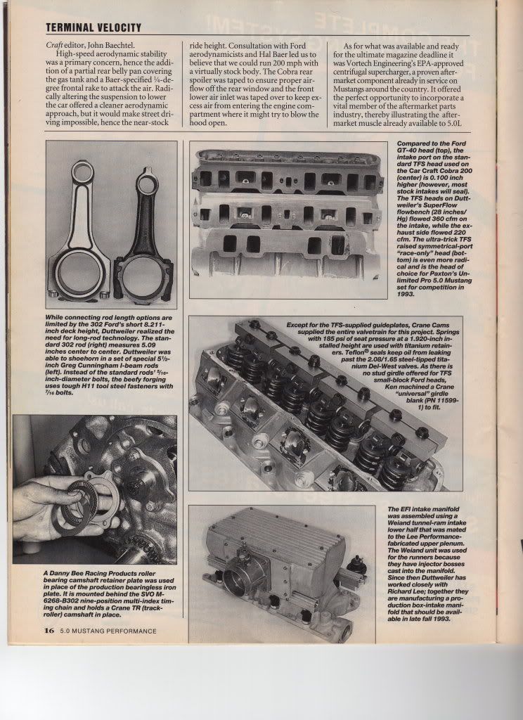

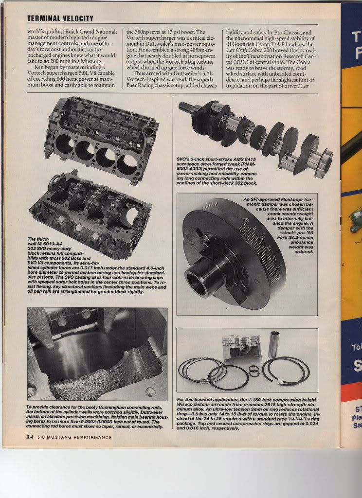

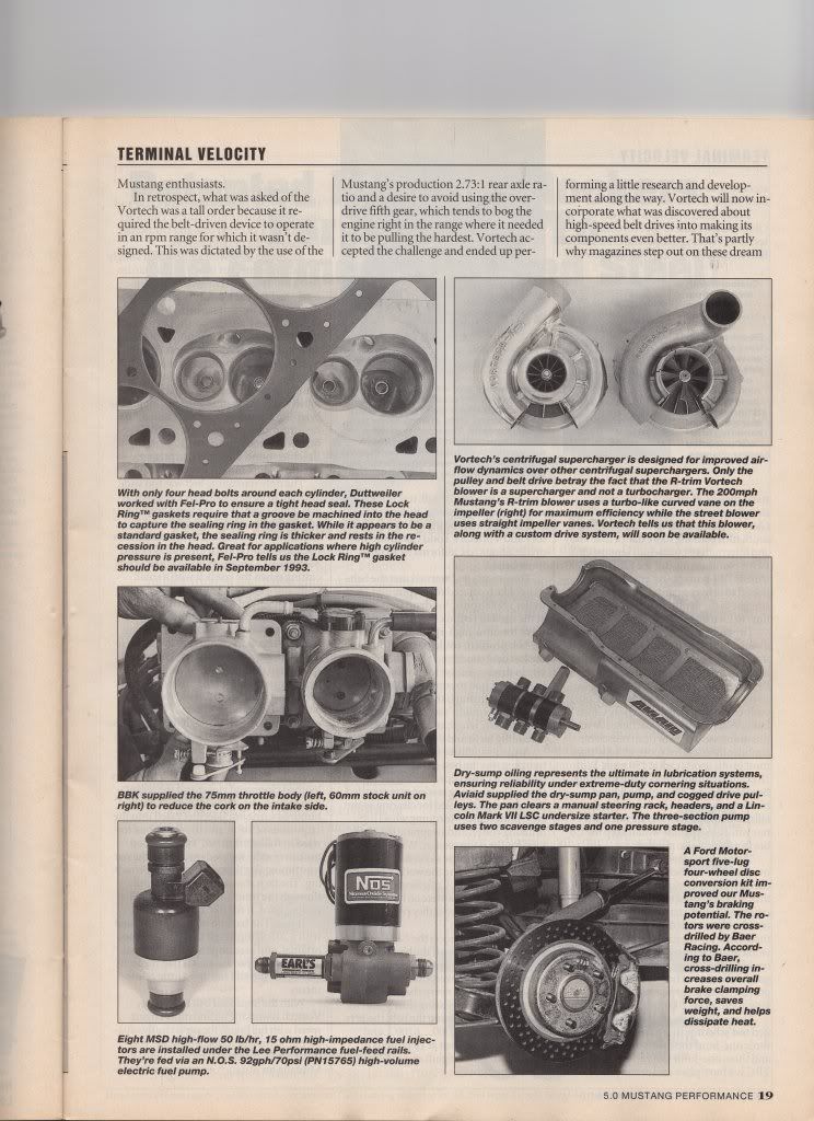

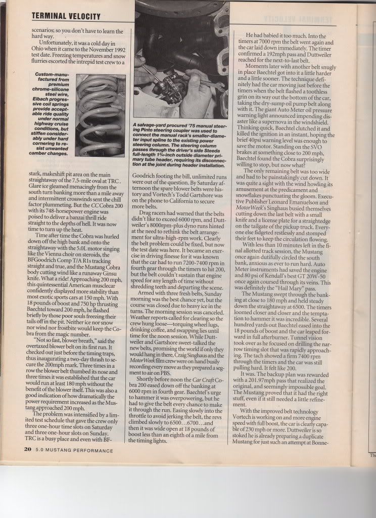

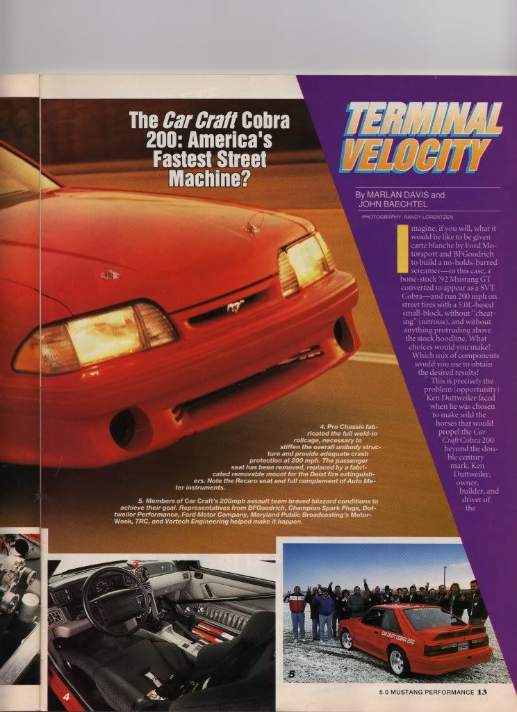

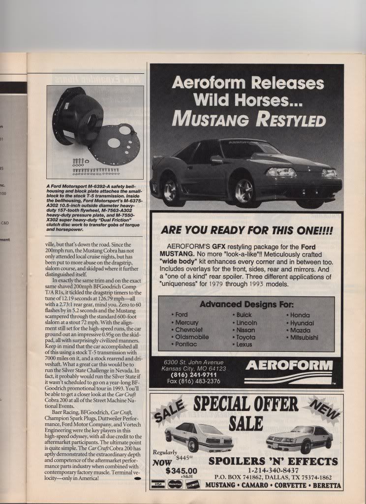

Back in 1993 Car Craft built a 93' Cobra to go 200+ mph. The motor was a 800hp Vortech powered svo motor built by Ken Duttweiler. The project was named Terminal Velocity. If you google it I'm sure you will find the article. The car was suprisingly stock as far as the body and suspension went, it even had the stock world class t-5 tranny, rear end (2.73 gears) and drive shaft. They went 201.97 mph in 4th gear at 7400 rpms. But they had a team of 18 to 20 people and a open checkbook!! Good luck with your goal, it will be an expensive one.

awesome, i'd been looking for that article for months and couldn't remember what it was called. Thanks, There was another guy, a Dr. who had advertised in the magazines looking for sponsors a coupe years back to do the same thing, also with a red 93' cobra. If anyone has any info on that i'd like to read it. See i'm not the only crazy one, i suppose if u drive a 93 Cobra some part of your brain melts into thinking you can go 200

Man, I hope I don't get in trouble for posting the whole article!!
