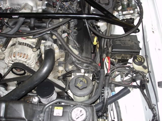

On my S-trim, I cannot run to intake, as that would pressureize it in reverse. Nor do I wish to feed steamy oil into the blades of the S-trim (gunk up impeller with slime). So I run loooong [dont laugh] radiator hose from the valvecover to the breather element. The hose itself is my catch can. (Also, acts as filler tube and allows me to pour into the engine, as I welded the valve cover tube right under the strut tower brace... DOH!).
Before:
After (STB oops discovered)

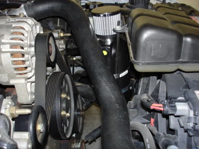

Here's what i've done so far. I bought a 30$ Summit breather tank. Inlet/outlet with top filter and drain petcock on the bottom:
The yellow "dot" is the outlet that is plugged.

Thats how I did it on our 01' Cobra. I'm going to do something similar on my fox soon.

Wow! that sucker is really hidden back there!!
