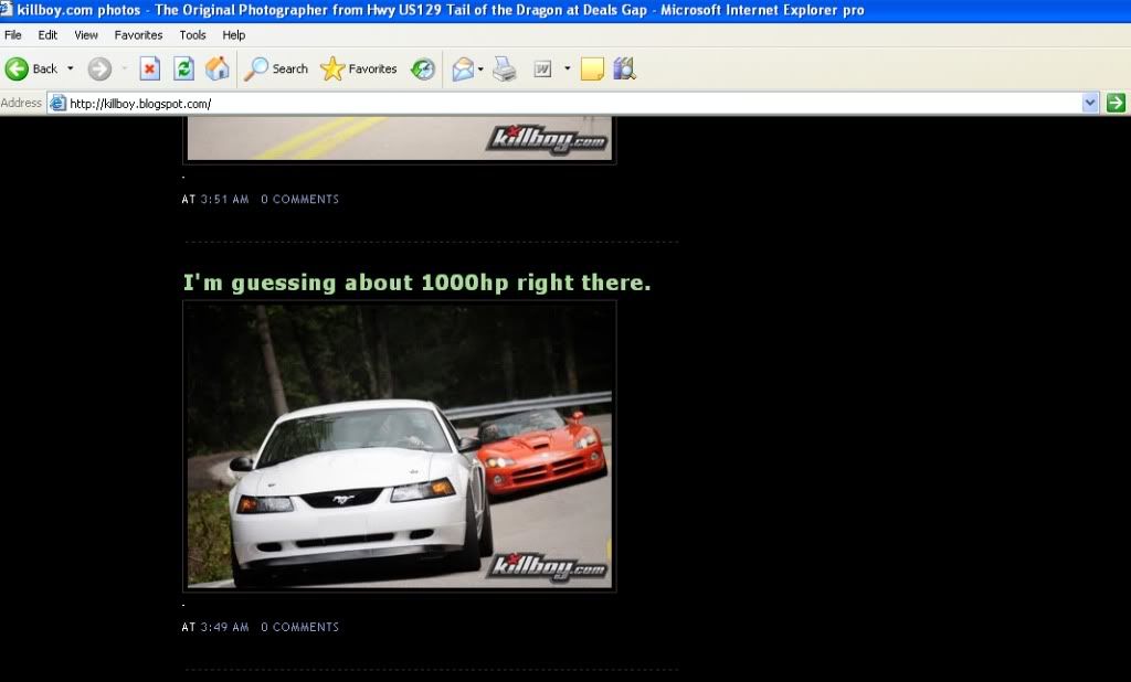

Well spank you, I mean thank you! It's a 5-footer for sure. Seen it's fair share of external abuse, but I do what I can.
Saw this on our local photo site / local famous curvy road spot today. They're a little off on the "HP" estimate(thanks to my car)
