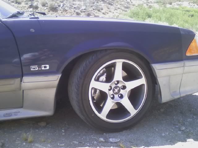

17x9 03 Cobras
Unlimited budget.....I'd have a diesel truck and trailer for the track, do more than 3 events a year, and daily drive an M3 instead of a 325i lol
