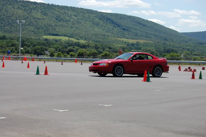

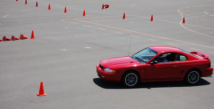

Here's a few pics from this weekend's autocross.
All I can say is I have to completely re-learn how to drive this car as it couldn't be more different than any mustang I have driven/owned over the last 15 years. I ran with the rear sway bar set on its softest setting and the front Koni's on full stiff. The car was very neutral on 90% of the course but it pushed hard in one of the last tight corners. If anyone has any suggestions on anything on the car let me know. This is the first mustang I've ever had that actually handles so I'll be the first to admit that I'm as much of a newbie as there is when it comes to setting the car up, but once I get into something I become as knowledgeable as possible about it. I've done a ton of reading here and on CC prior to even buying the car, but I know I haven't scratched the surface yet on what I need to know. Right now I think I'm done modding the car for the year as the driver needs more work now.
