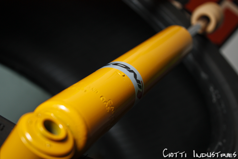

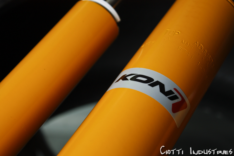

Koni single adjustables went on the Cobra this weekend and my god what a difference they made vs. the Tokiko Blues. The compression dampening is set and much stiffer than the Tokiko Blues that were on the car which makes turn in MUCH crisper and got rid of a lot of the instant front end brake dive which has made threshold braking oh so much easier. The rebound dampening is adjustable but even on full soft it is much better than the Tokiko's were at managing the weight of the big fat vert. I'm just starting to screw around (literally and figuratively) with changing the rebound so I'll have to report back on how that goes, but my initial impression is that it's going to be really nice to be able to fine tune this exactly how I want it for weekly daily driving and then crank it up for fun on the weekends and dial it in for each track layout/venue I'm at.
The car now rides much better on the street over bumps and pot holes most likely because the Tokiko's were underdampened for my stiffer spring rates(750 front and 275 rear) and the Cobra now rides a lot more like my girlfriend's 08' Jetta in that it sucks up bumps without upsetting the entire car. Instead of banging over every bump and slamming the wheels down into pot holes, the dampening controls the suspension so much better that I just cruise over bumps that used to knock the car all over the bloody road. There are 2 recessed manhole covers in particular that I hit every single day on the way home where previously they would send 2 wheels well over the dotted line into the other lane and now the car just goes thump thump with no drama at all and keeps on cruising dead straight.
There isn't any mod that I've done other than the MM full length subs that made this much of a positive difference to everything about the car, it brakes better, is more comfortable, and turns in so much nicer than it ever has. I'm also really happy that the bump/compression is set and not adjustable as it prevents me from banging my head into the wall trying to figure out how to get that set properly.
