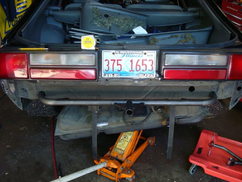

Toss the rear (metal) bumper and brackets - 40 lbs. weight savings.
That's worth 6-7 gallons gas in the tank.
'87 Fox C-Prepared Mustang
Zero scrub SLA front end
87Fox5.0 is offline
post #16 of 21 Old 07-04-2009, 11:07 AM
BULLITT1992's Avatar
Join Date: May 2008
Location: Ocean Springs, MS
Posts: 3,363
When you say rear bumper, what do you mean exactly? Are they 5 mph bumpers or is this the thing that is going to save your life if someone rear-ends you?
Yea, those.
On my old "race" Acura Integra....I removed both front and rears. On this car, that I drive to/from work on occasion and also on track.....no way.
Something like this is a little more on the conservative side:
https://forums.corral.net/forums/show...weight+bumpers
(minus the parachute option obviously)

Steeda makes a lightweight bumper replacement, but I was thinking of only using the one for the front. It supposedly saves 13lbs of the very front of the car. The rear saves 26, but if you use both, you are making your weight distribution go in reverse even though you are making the whole car lighter overall.
