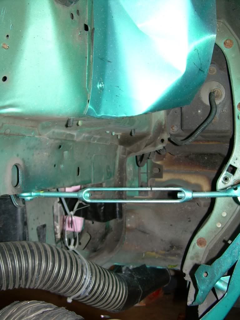

Even just running 245/45-17's on 17x8's, and in anticipation of some 255/40's, with standard-offset A-arms in the upper position of the MM k-member, I've had to ditch the fender liner and push the front lower extensions out with turnbuckles. I'll grab some pics of what I'm talking about later today
And the car isn't exactly slammed, but it's low enough that it called for the upper A-arm mounting point. Where you mount the A-arm is determined largely by your ride height. If the car is low enough that the line between the ball joint pivot and A-arm pivots angles up from K-member outward, you want to use the higher pivot points. This changes the roll center and some other factors but it maximizes your camber curve and bumpsteer performance.

Here's looking into the passenger side of mine. I removed a factory brace that tied the fender in, then installed a turnbuckle between an existing hole on the frame rail, and one of the nubs that mounts the trim strip to the fender using strap steel, fender washers and hardware I had on hand. I also installed a quick & dirty shield to protect the air filter intake hole from water and debris.
There's a lot of great info about spreading fenders on foxbodies in this thread http://www.corner-carvers.com/forums...ad.php?t=27194 and starting at post 118 in this thread, but you have to be a member to see the pics: http://www.corner-carvers.com/forums...ad.php?t=32461

Sweet, brilliant idea about the turnbuckle, thus far I've only seen a piece of square tubing used, nice that it's adjustable.

What is the purpose of the turnbuckle? Keep the fender from wagging?

To push it out/keep it off the tire.
That is pretty awesome on the adjustable turnbuckle. Great setup.

I ended up stealing the turnbuckle idea, mine are a bit different in that they have a solid aluminum body but they worked really well.
I ended up having only very slight rubbing even with the 275/40/17s on the Cobra Rs and that was only on super hard cornering at the track. Of course that was with Toyo RA1s, I just bought a set of same size Nitto NT01s from another guy and they look like they are taller and narrower so I may have more rubbing issues. I won't know until next spring.
