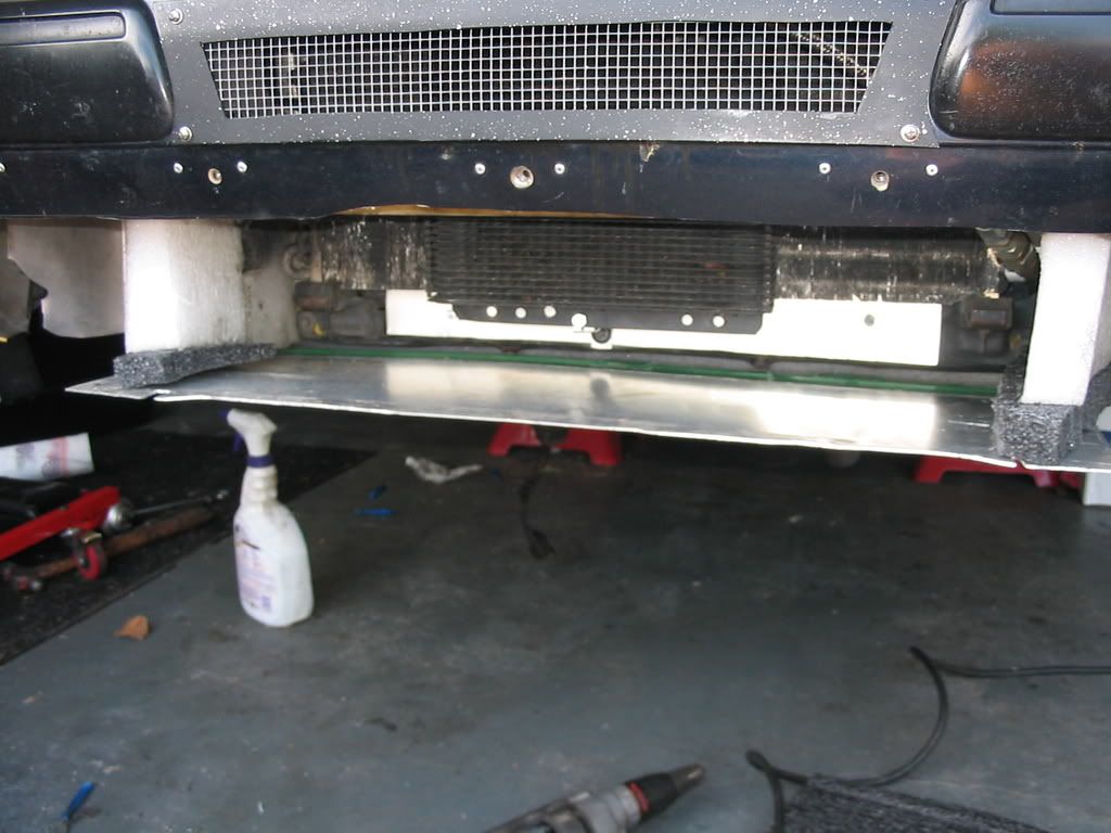

Her is my oil cooler install:
http://www.dariusrudis.com/2002_Oil_Cooler
Explorer oil/water cooler:
Darius Rudis
now thats awesome and simple.
Have you ever gotten an oil temp gauge on there to see what sort of temps it runs with that setup? I know the oil-to-water cooler on my N/A Subaru is only marginally effective - dropped track temps from ~270F to 260F. That Exploder cooler is bigger, of course, but so is the engine and heat load it's trying to cool.
