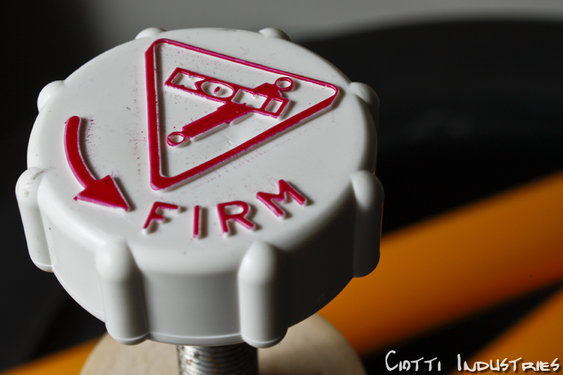

Just got my Koni SA's from Sam in/on the car this weekend and I'm blown away at the difference they made over the god knows how old Tokiko Blues that have been on the car since I got it. On full soft these are so much more comfortable over bumps and on turn in the car feels like it's on rails. I'm going to run them on full soft for another day to and from work tomorrow and then on Wednesday I'll put a full turn in the front to see how that feels so that I can start figuring out what changing the rebound actually feels like.
Sam, HUGE thanks for everything man you're a class act and I'll never forget about how much extra work you put in to get me the Koni's in time.
