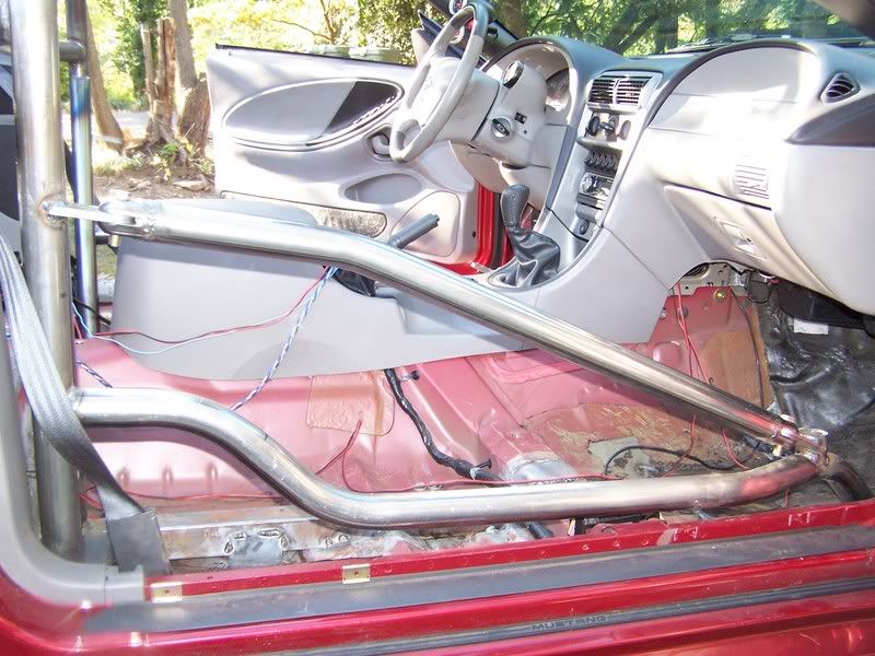

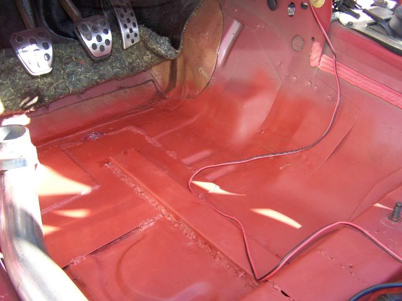

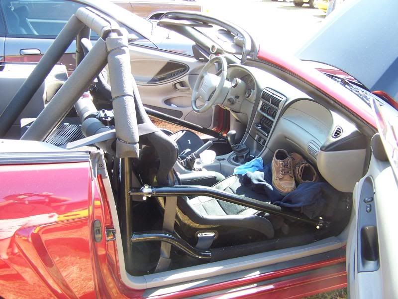

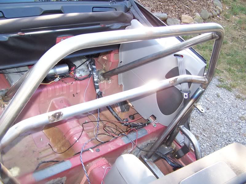

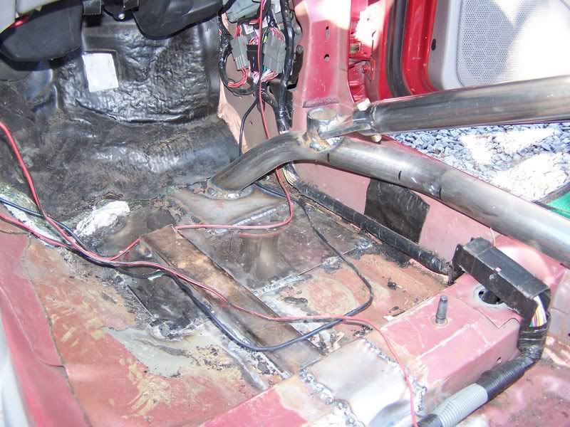

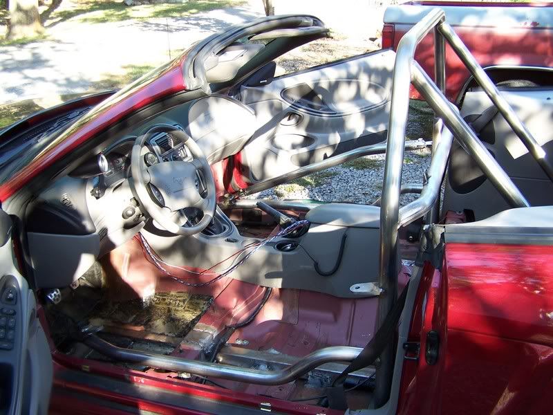

post #15 of 68 Old 07-03-2009, 02:56 PM
Location: Maryville, TN
Posts: 131
Ken03KBGTvert is offline
post #16 of 68 Old 07-03-2009, 03:01 PM
Posts: 131

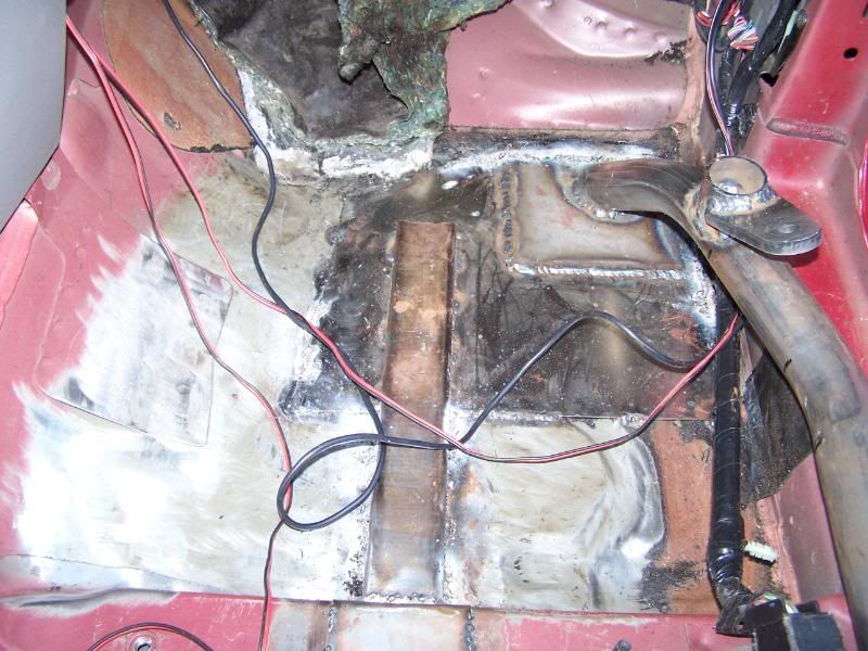

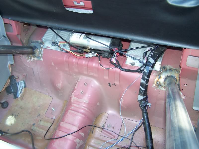

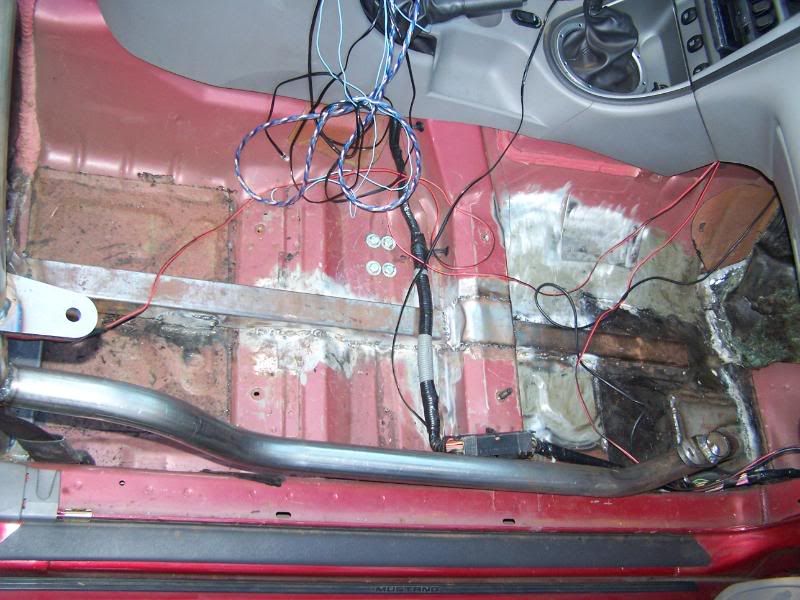

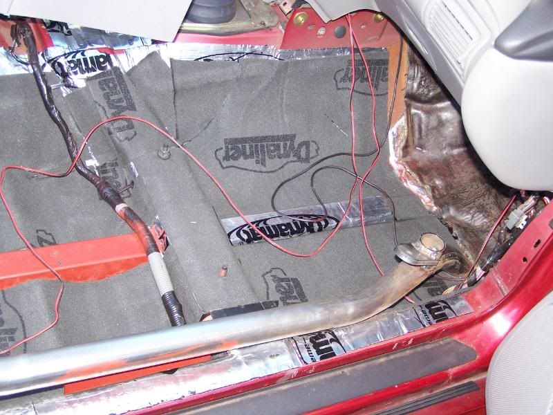

post #17 of 68 Old 07-03-2009, 03:02 PM
Posts: 131
post #18 of 68 Old 07-03-2009, 03:08 PM
Posts: 131

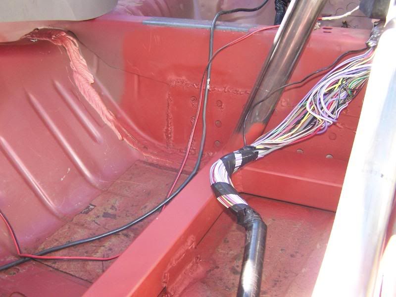

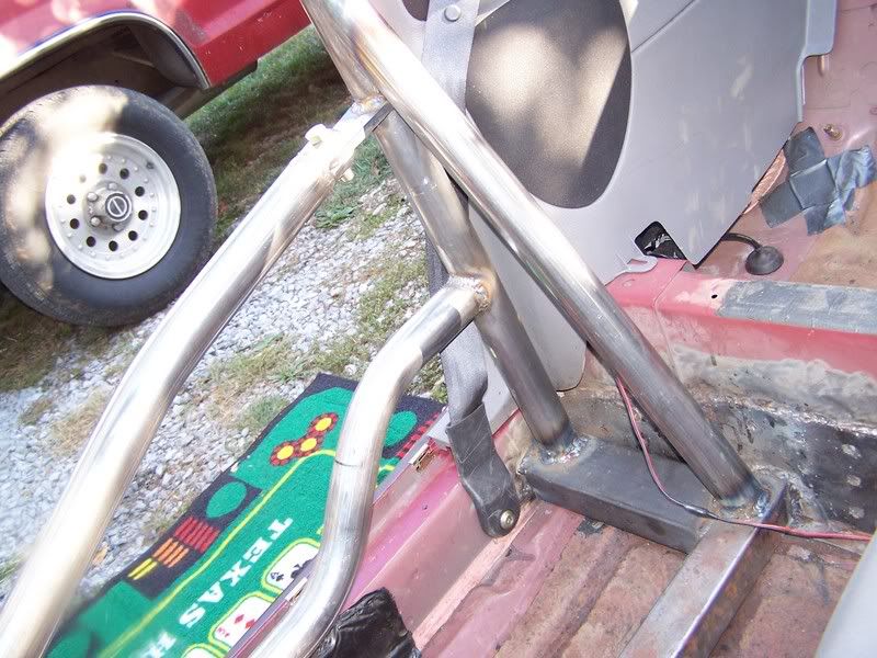

Posts: 1,436
I'll bite, lol.
Bent bars = weaker. Was that welded with flux core? Those welds look awful goobery like there wasn't enough heat in the weld.
Posts: 131
Most of what you see is sealant, not the welds. I used a lot of caulking crap everywhere once the welding was over. Some of the welds are my own, those would be the ugliest. I hit a few places that my buddy didn't. But his welds are no masterpiece, they simply get the job done. Two different people welded on the car besides the little bit I did. One did the cage, one did the upper SFC's. I take that back, three people welded on the car.Tim at MPH welded on the lower SFC's over two years ago. The upper SFC's were welded on in a barn last summer in 95* weather, we weren't real concerned with "pretty" at the moment, considering they'd never be seen again in person.
I did not want the lower bar bent like he did but when I came back to pick up the car it was done. Too late. With the upper bar bolted in (I BOLT them in, I don't just use pins) it still triangulates the two and I'm sure it's strong enough. If not, my love handles are the next line of defense and they'll surely be enough to protect me.
For anyone else, if it looks unsafe to you, don't ride in my car with me.
I just don't want to be with you while you're out there racing. That thing could fly apart and kill pregnant nuns visiting orphanages! U R N-SANE!!1!!
I heard from a reliable source you used exhaust tubing and not cage tubing. FA'REALS?!

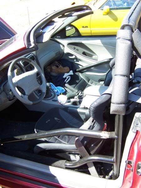

Just remember, there is a difference between not pretty, and not solid.
Also, I wouldn't think that top door bar welded to that little stub shaft would take much punishment, but like you said, its not my car. I built mine with three sided plating on the main hoop and front floor mounts (ran plate on the floor and both vertical parts of the corner) and ran straight pipe everywhere. It just seems to me like you went through the effort to do the through-floor subframe connectors, then went with a weaker roll cage setup.

Posts: 2,133
The door bars are a problem. I hope they never get tested...
Posts: 131

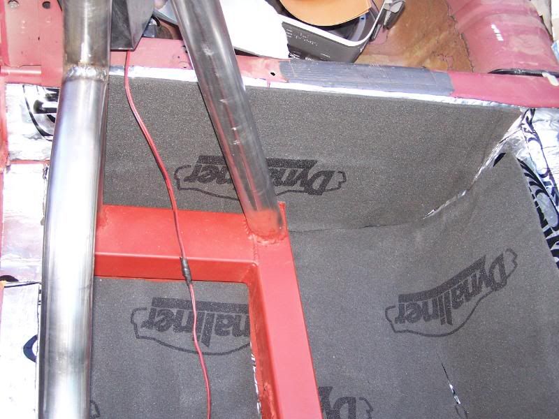

I got a 4X6 plate welded to a 12X12 plate which is welded to the floor pan. Under the car, there are a bunch of little hole drilled through the floor pan so the 12X12 plate can be welded through the floor pan, not just around the edge. The "stub" is welded to the lower bar all the way around it, the rest is standard NHRA approved stuff. The door bar passes between my shoulders and waist per NHRA rules. The tubing itself is thicker than standard stuff. I can't remember the exact thickness but the rules called for thicker stuff with a convertible so I got that.
Why is it a weakness? I'm not being a dick, just like to learn something. If I go a split second faster drag racing, I'll have to either slow down or put a cage in the car, so I'm not going to change the door bars anyttime soon unless I'm taking that part out for a full cage. Just wondering where this weakness is.
