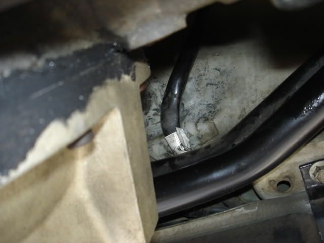

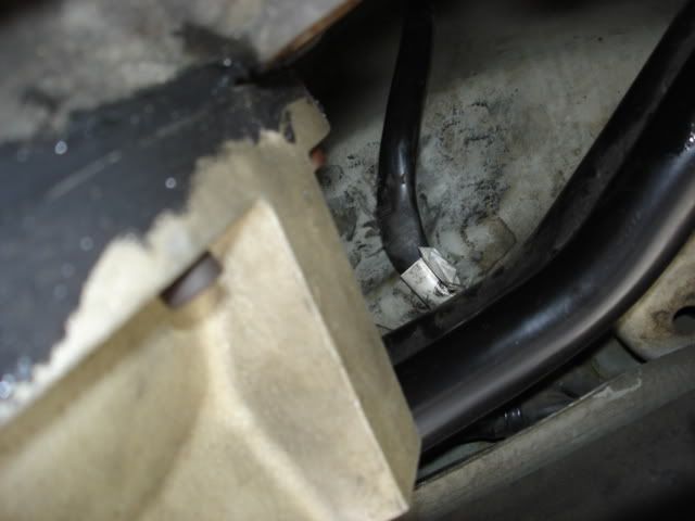

Running tailpipes on your track-driven Mustang? Check your fuel lines!
I just had to replace the flex lines between the pump and filter on my 92 5.0, because they had somehow reached the Dynomax 2.5-inch tailpipe frequently enough and/or long enough to create the damage you see below. The one from pump to filter was >this< close to melting through the inner line, and I can only guess that would have cost me one hell of a problem if it had let go. It didn't look like this when I installed the panhard bar last year.
I don't even know how it happened, because I couldn't make them touch with my hands, tugging on the lines, tugging on the exhaust, trying to move the tank, nothing. But they had been making contact, and yes, the exhaust pipe was already wrapped with heat wrap.
Now the new lines are wrapped with heat tape AND wrap, and tied out of the way with an epic display of zip-tie engineering prowess. Even still, you can see the proximity and why there might be a problem.

It's a common failure, especially if you run a lartger aftermarket exhaust.
If you run factory fuel lines and haven't done anything to protect them and get them out of the way, it WILL happen to you sooner or later. Mine happened on the track at Hallett years ago and I ended up with a fine mist of fuel spraying out of the rear wheel.
Tie the lines up out of the way, wrap them in a thermal barrier like Thermotec makes, and wrapping the tailpipe like MFE did would be an excellent idea too.
Me? I eliminated the problem by going to a side exit exhaust.
I had some similar "events" happen a little over a year ago. I changed the fuel pump and didn't put the lines back up in the little gutter around the tank. The line melted on the way home from Disneyland. I also made some Zip-tie "art" with the new line.
