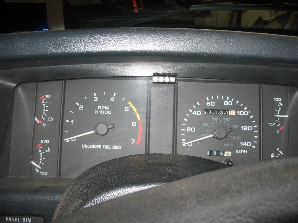

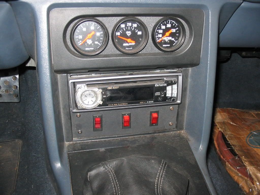

Here is what I did to my 90 LX. I like to keep a low profile and did not want the A pillar gauge setup. I wanted a shift light because I run the car at HPDE and open track events and sometimes it is hard to hear the engine and I am sometime a little occupied in the middle of the turn but did not want a big aftermarket tach. I made a small board with LED's and mounted it inside the dash bezel and bought a rpm switch from Summitt.
I mounted mech. water temp, elec. oil temp and mech. oil pressure where the HVAC controls were...ALL the factory gauges work as well.

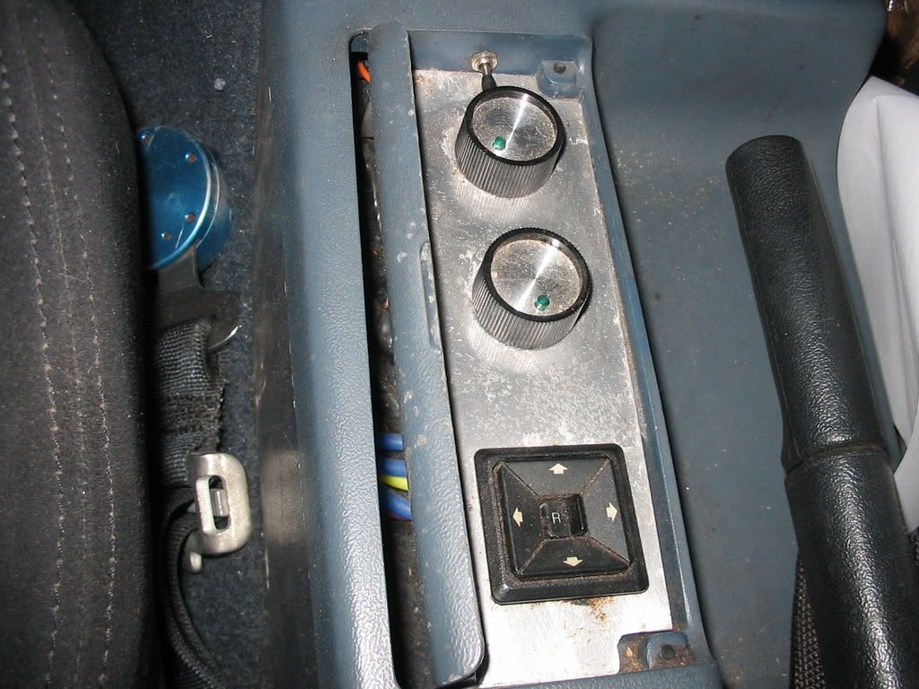

...and put the HVAC in the center console. Everything still works, a/c, blower. Even mounted an actuator to control the heat/cold blend door. Even the ash tray door still closes and the knobs have LED built into them.
The red switches control rad fan over ride, ABS and oil cooler fan.
