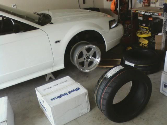

Figured i'd document these since they both seem kinda new to the scene. Maybe it'll help someone else out.

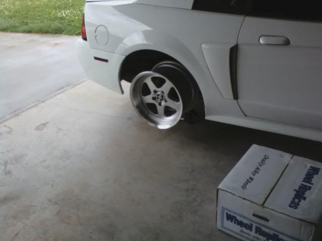

Hope to have them mounted up this week. The 315's measure tread shoulder to tread shoulder right at 12"
The 9" fronts come exactly flush to the front fenders(using GMS K-member)
THESE ARE CAMERA PHONE PIX, I'M TOO BROKE TO AFFORD A CAMERA AFTER ALL THIS
SC Style 17x9 fronts and 17x10 rears with 275/40 and 315/35 Nitto NT05 tires
Pretty large void area and thick strip in the middle of the 315's

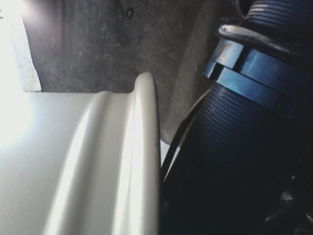

The below is with the spindle pulled TOWARD you(decreasing neg. camber). I can get way enough out of the plates to run like this

Meant to add that the 17x10's DO NOT FIT the fronts WITH COBRA BRAKES. However, the rubbing is so slight on the bulk part of the caliper that it could easily be ground down to work with no issues.
I was going to run 10's on all four corners, but with the K-member kit pushing the wheels out further, the 10's just stick out way too far.

No clue, i'm no tire engineer. I imagine it's for water evacuation. Thats a pretty massive hydroplane-prone steam roller of a tire.

The 9's up front have about a pinky finger width clearance at the closest spot. I don't think you'd have an issue. Even if you did, a couple mm's of grinding in a non-noticeable area would take care of it.
I was honestly surprised the 10's fit as well as they did on the front. I may still end up trying a seperate set of 10's up front for track events. No time soon, i'm broke as a joke and about to choke.

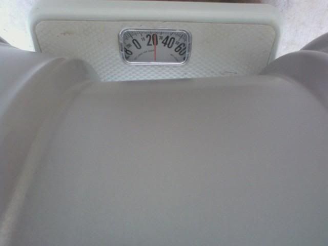

I love the look. The weight isnt bad considering how big they are.
