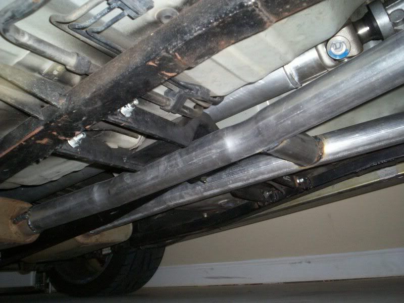

The shop that put my TA on modified my OE setup. They didn't cut/re-weld anything just kinda tweaked it down a bit and rotated the couplers a bit. It still kinda banged/clanked around from time to time.
I went with LT headers and after a fiasco with the PYPES ill-fitting shorty H-pipe, I got my money back and just went MIDAS.
It's sooo much more clean/simple now. I think MIDAS charged 150-180$ for mid pipe.
Hi-Temp rattle can coated. 4 nuts and the whole exhaust is off:
