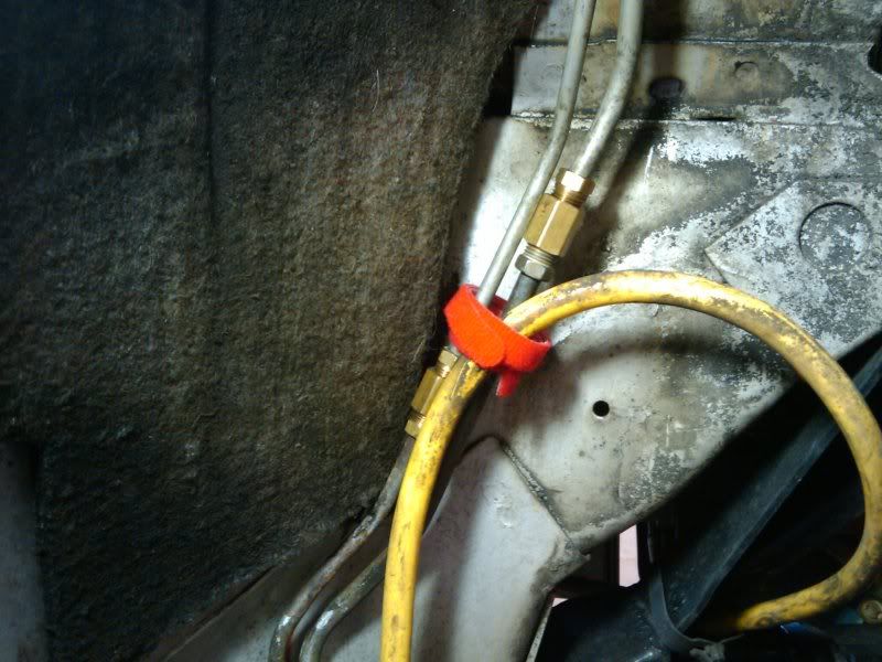

double flare fittings and T fitting can be found at any automotive store..
If this is your first time flaring...be sure to practice on some spare lines before working on your live pieces.....
double flared some fuel lines for the swap as well...notice your fox is a 4 cylinder...which means your fuel lines come from the driver side as the v8s come from the passenger side:
reason i put back the stock lines was that the braided AN lines started to have vapor smells ....
