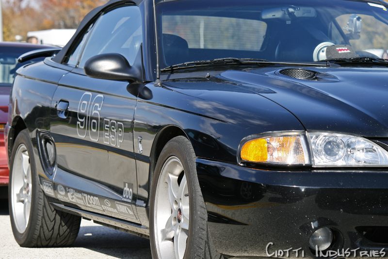

96' Cobra with 17x9 m58 Cobra R's, 800 lb. front springs, and 1.5 degrees of negative camber, I want Kuhmo XS 295-35-17's on all 4 corners but I'm worried that they will rub up front on corner entry when I'm hard on the brakes.
Right now I have 275 Toyos and they do not rub at all but they do look pretty close to the fender lip...
I'm tempted to just get them, but I'll be pissed if I spend $800+ in tires and then ruin them every time I stand on the brakes. This is a daily driven car so I can't just dial in 3 degrees of camber if they do rub (nor do I want to as I'm not willing to sacrifice straight line braking) so I guess I'm sorta screwed if they rub... any ideas???

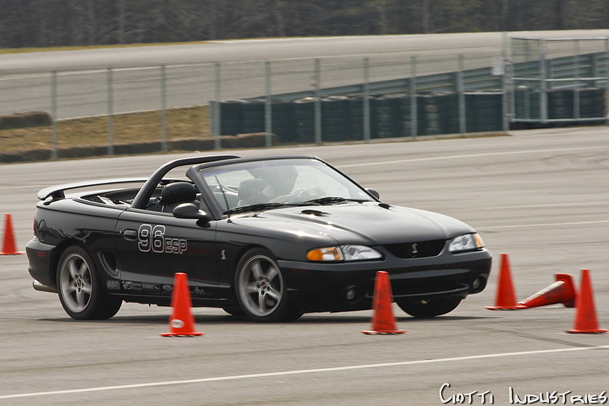

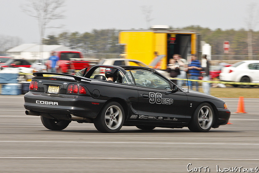

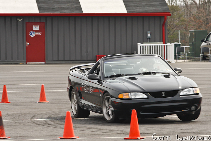

When I look at pictures of the car under full braking I feel like I'll be ok, but the 295 XS's will be much grippier than my current 275 Proxes 4's so there will be more suspension compression with them...

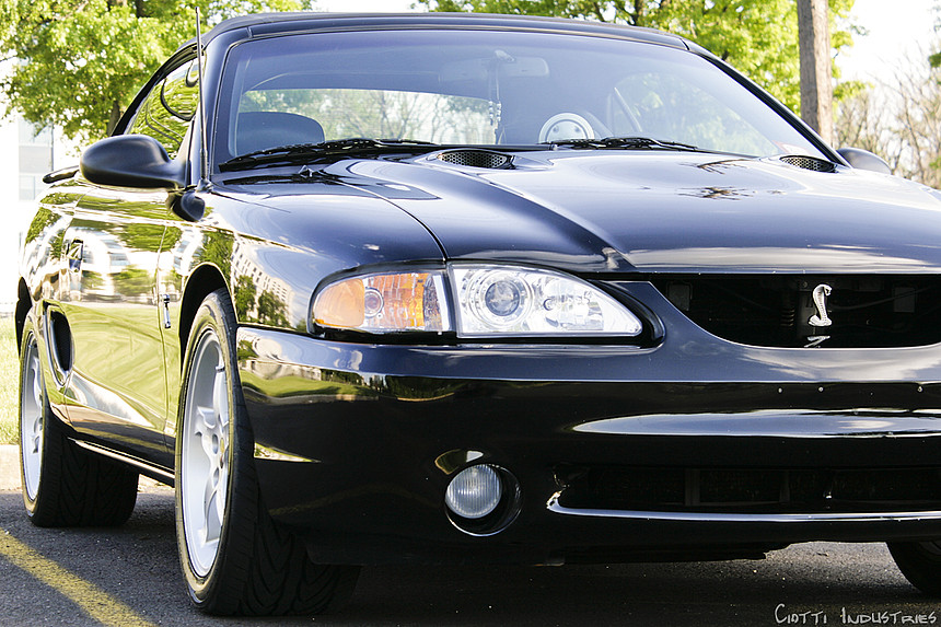

I wound up getting the 285 40 17's and they're BIG, at least a full inch wider than my 275 Toyo's. I noticed last night that they only hang out on the driver side which didn't make sense at first as I know the camber is the same on both sides, but then I remembered that the driver side front quarter panel has much fresher paint on it than anywhere else. So, I'm assuming that the driver front was hit at some point and when that panel was put back on it sunk in a bit further, so now I'm guessing I have to get that fender rolled to get that clearance back as my factory CC plates are maxed.
I'll get some pictures of the tires tonight, they're dead sexy!
