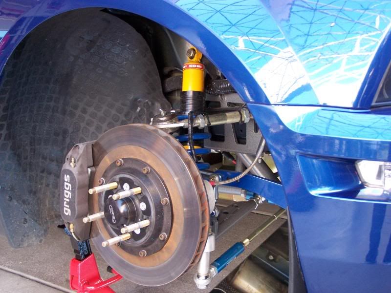

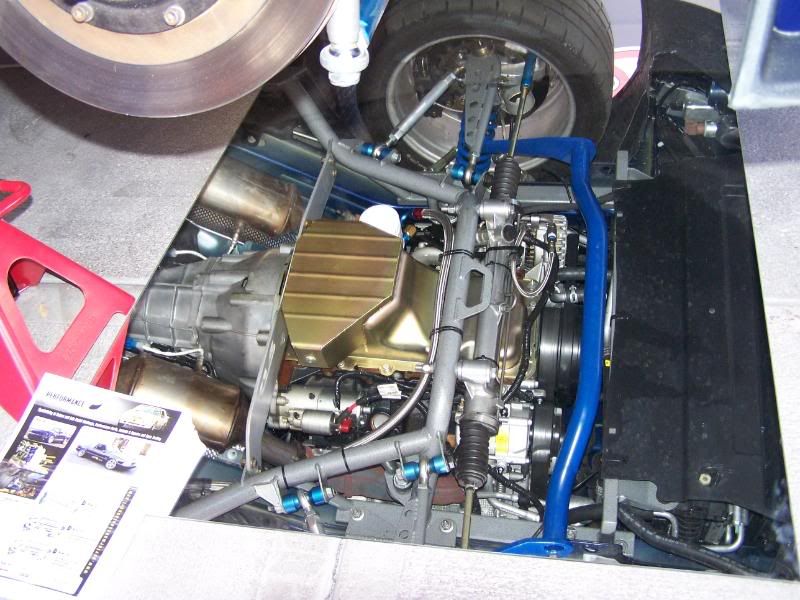

heres one i snapped from SEMA from a GT500
I know were all on a different platform...
