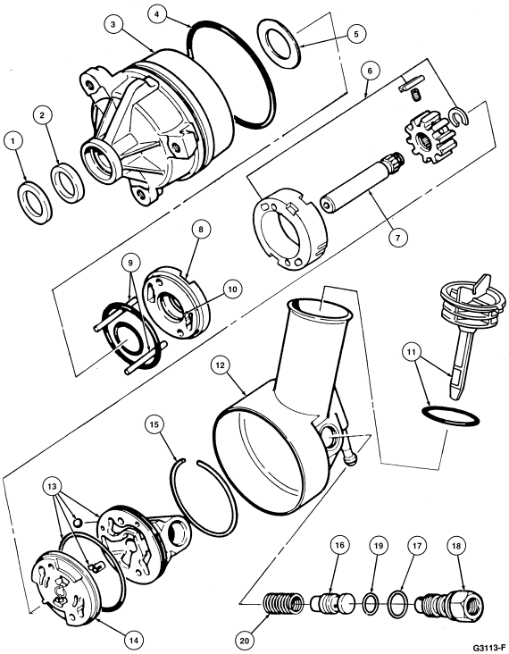

The only thing I can think of is that I have two bad pumps?? Doesn't make any sense. One thing to note, I removed the pump fitting from the reservoir to inspect and found no debris inside. The spring, plunger, and fitting all seem to be fine. Can the plunger become clogged somehow??
This is the way I reinstalled the pump internals, is it correct? BTW - this picture shows the large fitting without the main o-ring. The parts shown in the picture are spares... I have the main o-ring installed on the fitting that is actually on the car.

you have it installed correctly...assuming you have both seals on the outlet fitting...I only see one there on your spare part picture..
this has me wondering as you have swapped both pumps and rack...I know the luxury ford setups come with a VAPS system...which basically adjusts the spool valve depending on engine speed thus providing full PS @ low speeds and less PS @ high speeds to give the driver better feedback..
