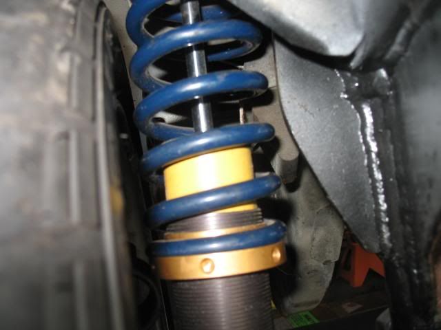

I finally got my new 3 link 9" rear together. With the combination of north racecars brackets and my cobra rear brakes and custom length axles i managed to fit 305/35-17 inch tires on 17X10.5 wheels mostly under the rear quarter.

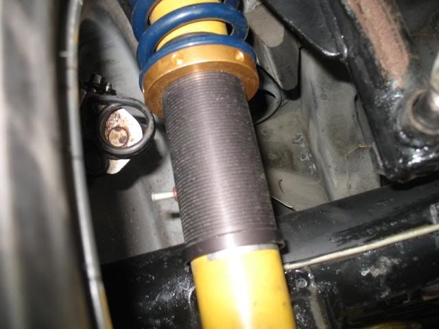

I do not like how close the MM coilovers come to the tire. What do you guys think?

I've never really looked at how close my 315's are to the coilovers in the rear on my car but I've seen no signs of rubbing on any of my tires. I'm a newer body style too though.
Your rear is going to move left/right some as you turn hard. It will move IN on the side that compresses so it may clear your fender, "tuck in", when you turn hard. So you may not have an issue with that.
But in that second picture, that tire looks REALLY close to the the coilover. May just be the picture making it look that way. Can you give an estimate on how much distance there is between the coilovoer and tire?
The side that may clear the fender may also hit that coilover?

i would (and have) roll the quarter lips up and out giving you another 1/2" of tire coverage. then put some 1/2" mm spacers on. see mine

you can also eliminate that crusty old stock bumpstop as its in with the new coilovers.

Thanks, Pls send me more pics or a link to your build... the lips are rolled and I could try to flatten some more. What size tire is that on your car?
Yes, the newer car handle the 305, 315s really well, the wheel and tire came off a 96 cobra. There is less than 1/2" between the tire and coilover

As it is okay. But a panhard will move the rearend side to side a bit.
